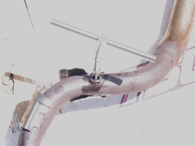

After a lot of struggling under the car, this is what finally came out of my 'S'-pipe! Lovely, eh? Needless to say, it doesn't thread into my CEL Eliminator and the Eliminator doesn't thread into the bung .

I presume you're talking about replacing the 'S'-pipe bung? I'm wondering if I can run a die over that wasted sensor thread and get it good enough to use, and perhaps a tap would recover the bung. Course, I don't yet know what thread size it needs !

OK! By grinding the destroyed thread and filing the entry to the remaining thread, I'm now able to cleanly install the sensor into the Eliminator. Can someone please tell me what tap size I need to restore the O2 bung thread?

From hunting around on the net, it appears as though the correct thread spec is 18mmX1.5. It also appears the O2 bungs are normally much harder than the sensor threads and so a chaser may well be sufficient to clear it. However, since I can't even start the Eliminator into the bung, it seems unlikely I'd have any better luck with a chaser !

Picked up a chaser today and spent some quality time (???) with the 'S'-pipe trying to remove it from the car. After soaking the rear bolts with solvent, I was finally able to break them free with a breaker bar and took the following photos of the bung threads.
Looks to me pretty much like metal was poured over them ! Tried the chaser a little, but all I was doing was hurting the chaser threads. Just ordered a tap and so the car will remain dead for a few days -- thanks Toyota !

Finally, back to where I should have been Sunday! Though, I hadn't really expected to have to remove the 'S'-pipe.

I used anti-seize on the front sensor, Eliminator, and 'S'-Pipe to scuba bolts, but I had to reach up above the pipe and Eliminator to install the rear sensor and chances were too great my fingers would contact both the compound and the sensor tip -- really poor accessability while lying on my back under there. I tried orienting the Eliminator forward, but then the sensor cable was too short -- if I have to remove it in the future, I'll probably be glad it only has three threads since it won't be able to fight as hard !
I'm quite certain it was cross-threaded, the three surviving threads were mostly protruding from the bung when I started, and the crushable washer wasn't tight. It was a couple or more orders of magnitude harder to turn than the front sensor.
