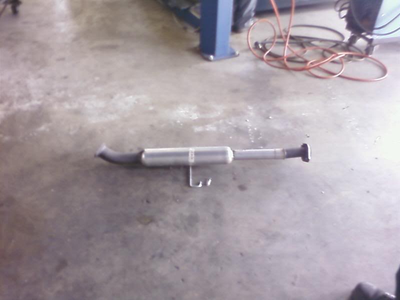

kkk Just remember the resonator has a cat in it! (hence the list price is over 800$)... I have a cat delete and when I got a ref ticket the guy went like ape ****
What I did was a simple between the bolt 13" generic resonator keep the raspy sound out..

Here is a vid so you can hear the outside.
Reso delete, hks axle back, TRD intake... and all the other common goodies
P.S! if you get pulled over and ur car is found to have no cats... In cali they can crush ur car if the cop is a dick
