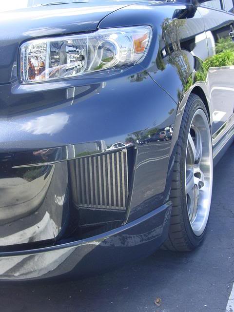

I believe that the bolt on kit comes with this inter cooler and if you want it to breath and get more power with less effort you should do this n_n

Old Oct 18, 2011 | 10:12 AM

In my opinion that SMIC looks sick, but with the other one it would look more like a sleeper and the TRD CAI might work with the FMIC. As far as I have read here the FMIC was an upgrade for the Turbo Kit and anyway both are good choices.
Originally Posted by Clean_XB
that looks interesting, but rob said today that the SMIC is just as efficient flow wise, as the FMIC.
FMIC is for those who want the look, or dont like the off balanced look of the SMIC.
Flow rates in both locations are identical

Looking forward to seeing some dyno runs and air temp comparisons of that smic vs an xb2 with a fmic.

There is no "best" IC for a boosted XB. Only what's "best" for a particular application and owner preference. If I were trying to squeeze every last bit of power from my engine I'd definitely go for the larger FMIC. OTOH, the SMIC is adequate for up to 400whp and I plan to stay well below that. If I simply swapped my SMIC for a FMIC I would probably lose some power due to the extra IC pressure loss. I'd need to raise my wastegate boost pressure to compensate.
It's not necessary to cut the bumper fascia like pictured above to run the SMIC and 300whp/tq. Simply removing the blank vent cover should be enough. You guys are correct in what you're saying though. The FMIC is certainly the most efficient and the SMIC would be more efficient with the front fascia opened up and a large hole cut from the fender liner behind it. I'm just saying that because we're all limiting our power anyway for reasons like auto trans, stock block, etc., it's not necessary or even beneficial to cut the bumper or go with the FMIC. If you're staying below 400 whp just choose the IC setup you like best.

"to each, his own in this case"
That sums it up quite nicely. I also went SMIC to retain a sleeper look but SP2 did a great job of hiding his FMIC with the black IC, couplers and pipes. IMO either IC should work very well for the typical 250-300 whp/tq turbo setup we see.
