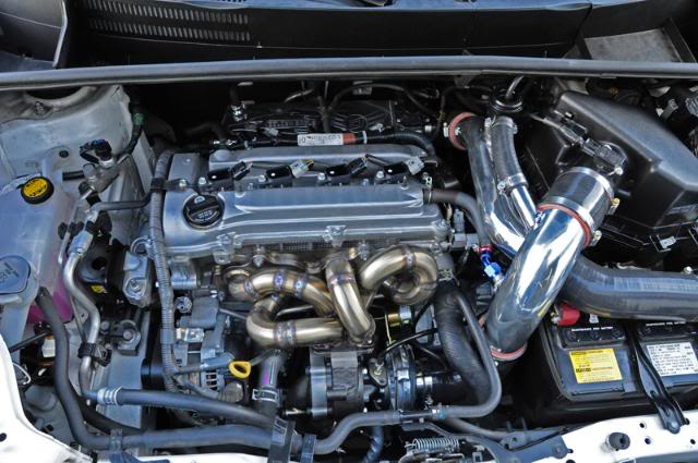

New DESCENDANT build running the streets of L.A.
DESCENDANT "Bolt on & Go" Kit
DESCENDANT Intake Manifold
otherwise stock...
Dyno tomorrow...dyno sheet's tomorrow night!!

whats the boost level?
8psi

Here's some better pictures...

I bet it makes 270-300 the mani is gona help alot should be good
After street tuning it I bet it's closer to 315-320WHP. It's taking ALOT of fuel!
I'll post results tomorrow after we get off the dyno.

so the vehicle mush not have a stock exhaust or it won't hit thouse numbers
correction...yes, I agree & it does have a aftermarket exhaust, my bad I didn't know that at first. Anyways...not sure what kind but I'll double check in the AM.

I think they had issues with the harness. I guess some people are having issues with cam and crank sensors. I have a boomslang harness and we were trying to figure out why I dont
Old Oct 24, 2009 | 09:01 PM
Rob_DESCENDANT's Avatar
Joined: Feb 2009
Posts: 1,418
From: Torrance, CA / Reading, P
yep...had some harness issues with our first boomslang xB piece but after reviewing the boomslang wiring diagram & our wiring diagram we found the problem & headed back to the dyno.
At 8psi the car made 298WHP & 308TQ. I'll be posting the dyno sheets/graphs & some video next week once I get back in the office.
FYI...when comparing this to the last 2ndGen xB we did which was identical minus the intake manifold we are seeing an increase of 17WHP & 19TQ which is right on point with what we expected.
IMO...boosted applications @10psi + will see 25WHP+ gains.
