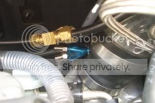

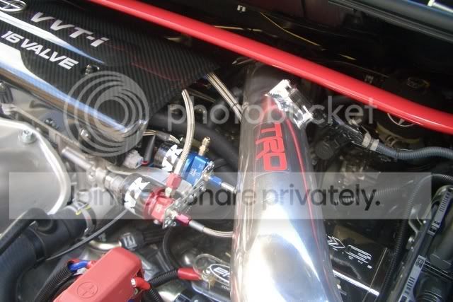

very simple to install just plug the fogger in the intake..

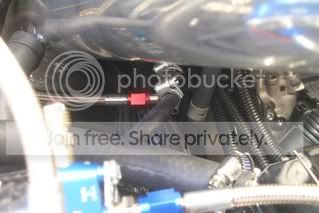

Tee into the feulline..
