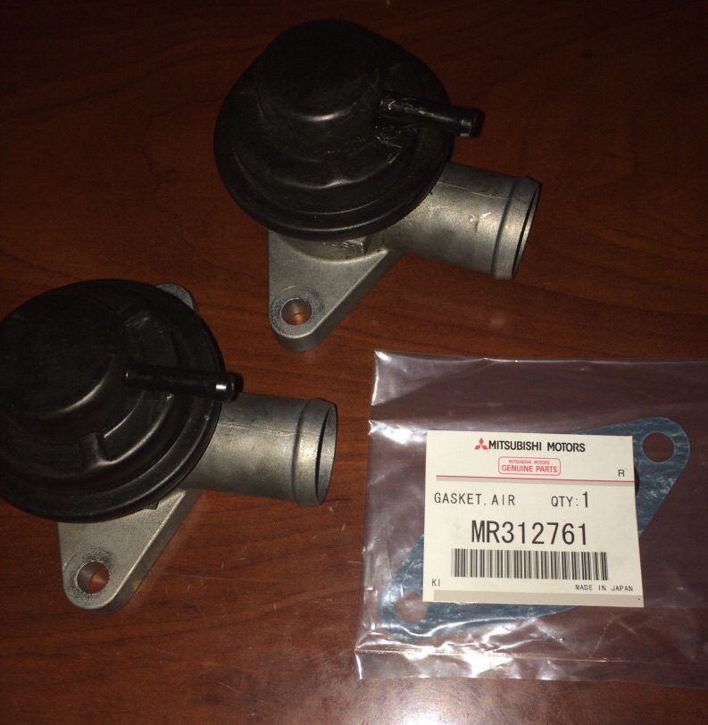

I'm still taking it slow, but shopping for parts has been enjoyable. Got my 2011 Nissan GT-R BOV(s) and gasket today:
(yes I know these are technically bypass valves)
I was searching for *the* most reliable BOV, recirculating or not, and it turns out that the 1st generation DSM BOV wins that title hands down. I started searching for one in good shape, only to find that most have 100k+ miles in them or have been modified (crushed) to hold at higher pressures. When I started looking for a new one, I found that Mitsubishi no longer makes them!
Long story and many hours of research later, I found that the current GT-R uses a newer Mitsubishi BOV that is, as far as anyone can tell, exactly the same as the one used on the old DSM. To make things better, these are constantly removed for upgrades in pairs, and I was able to get the pair with 10k miles and a new gasket for under $50. I'll probably sell off the second one to recoup some of that cost since I only need one BOV.
I haven't decided on a mounting flange since I don't have all of my cold side pipes planned out, but weldable flanges and 1" hose adapters are available on eBay.

Run a similar BOV on my EVO9. Currently at 27 psi & it works perfectly
Appreciate the work youre doing on the S-charger
