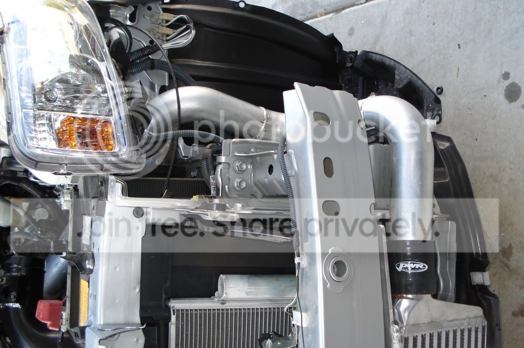

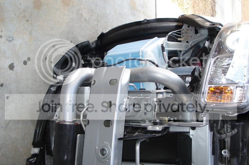

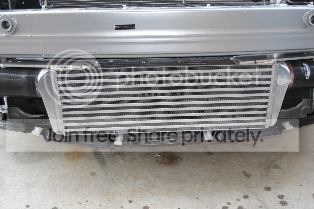

Here are some teasers for you guys. Picts of one of the two different styles of kits I offer for the 2nd gen xB
The wg and bov flanges still need to be welded, but you can get an idea of how things work.
Only 3 intercooler pipes!!!
1 hot side
1 cold side
1 intake
(piping in the kit will be powdercoated black)
Enjoy!
Cold side pipe:
Intercooler:
Hot side pipe:
Regards-
Todd
PS- have finished picts tomorrow night

can you release any more info about the kit, what Engine management, size of turbo,how you are planning to run the oil and coolant lines, injectors size, expected power output. I told myself I wouldnt do anything crazy but you guys make it so hard.
-nick
Using AEM FIC, but you can also use the Greddy Emanage etc.
550cc plug n play injectors
Turbo is a T3/T4OE 57trim with a .63ar turbine housing
No water lines, but oil feed/return work the same as the TC kits.
Power = depending on the psi you want to run 250-300 (5-10psi)
would totally love this more if i wasnt an idiot and got the auto....
Why? The car pictured is an auto
Will the battery have to be relocated?
No sir....the battery stays where it is....just like in the picts.
