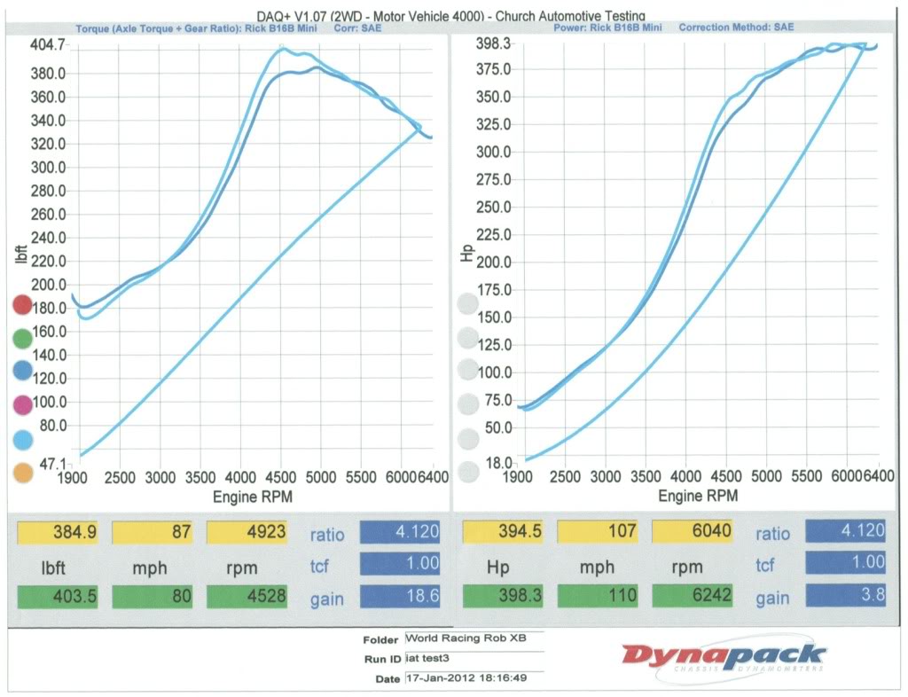

Just got back the from dyno with one of our build short blocks with AEM EMS2 and a DESCENDANT Turbo Kit.
Light blue light 17 psi and Dark blue 15.5 psi. Both run were back to back with no cool down.
Set up is WORLD-Motorsports Short Block, Stock head with DESCENDANT intake manifold, DESCENDANT Turbo Kit, AEM EMS2, 2.5 exhaust with high flow cat. Car had 100 oct in it.
