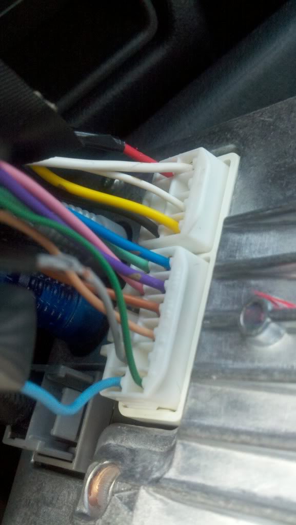

Update !!! all the wire are installed and the amp too but it doesn't work. I think it's the remote wire there is 3 different gray wire at the back to the unit...
Here is the unit
Here is the back of the unit
here is the first gray wire
and here is another set of gray wire .....
im confused

ahah thank you i figure out the problem with the remote i needed to use the red wire.
It's working like a charm now

Can you tell me which red wire...
according to your "im confused" photo which one is it? is it the red under your finger?
Old Sep 19, 2011 | 12:21 AM
Solo413's Avatar
Joined: Sep 2011
Posts: 6
is the red all the way to the left when looking at the back of unit. I popped it into the gray is that the remote cable?
I'm just confused, thanks for the on-off on radio but still no bump

It's the red wire where my finger is on the last picture

That's weird I used the gray for a remote when I was running my stock HU.

Well here is my cluster... now im confused...
Old Sep 19, 2011 | 09:10 PM
Solo413's Avatar
Joined: Sep 2011
Posts: 6
The gray on that is blurry was stripped and attached to the radio....

If I'm not mistaken that is the gray wire I used does it not turn the amp on when you put your key into acc.?
Old Sep 20, 2011 | 01:58 PM
blauzon's Avatar
Joined: Aug 2011
Posts: 6
From: Montréal-Québec-Canada
I just recheck it's the gray wire but they add another piece of wire between the original one and the unit ( maybe for the bluetooth or my remote starter with alarm ).
So normaly it would be gray yes
Old Sep 22, 2011 | 12:14 PM
Solo413's Avatar
Joined: Sep 2011
Posts: 6
Solved it. The subwoofer that was the first one that was being tested, the cables inside came loose, because of it being moved around. THe GRAY cable is the RIGHT one... Thanks guys, thanks for all the help.
