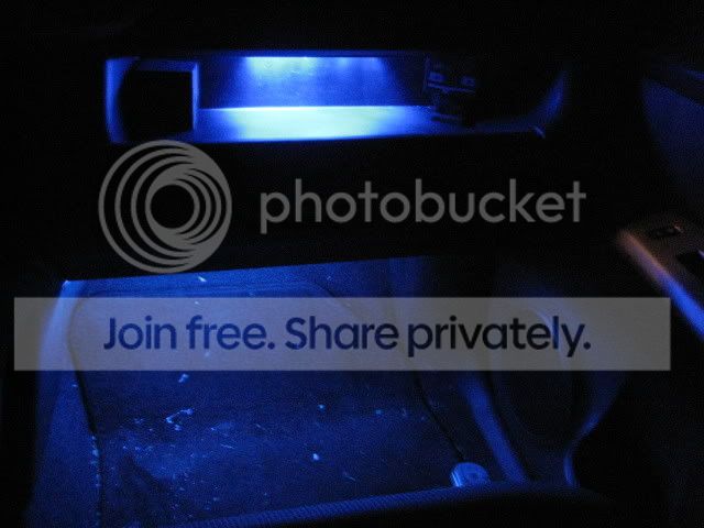

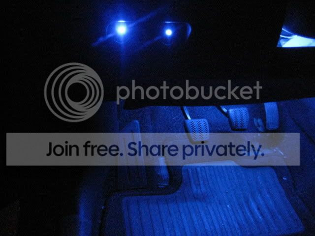

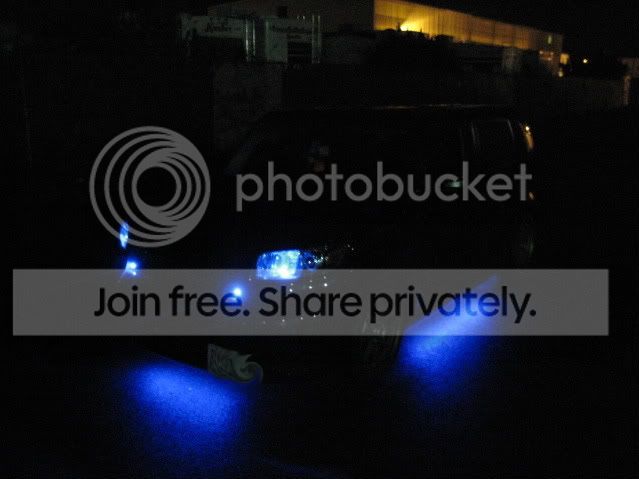

Sorry for the size.. The blank switches should pop out, or just pull that panel off and press them out from the back. One switch is for the lights in the car, the other is for the LED's in the Grill/Headlights

damn that is sweet. where did you get ur parts from?
the blank ones pop out meaning ...by pulling them out?
did you just drill into the blank enough to fit the rocker switch?
also, those led switches seem bright as he ll...are they distracting in your opinion?

The LED strip and Cathode I got from Oznium, switches from AutoZone..If you use a vrey small flathead screwdriver the blanks will pop out, or pull that panel off..It snaps off/on. As far as the brightness, its not that bad. They arent on all the time.
