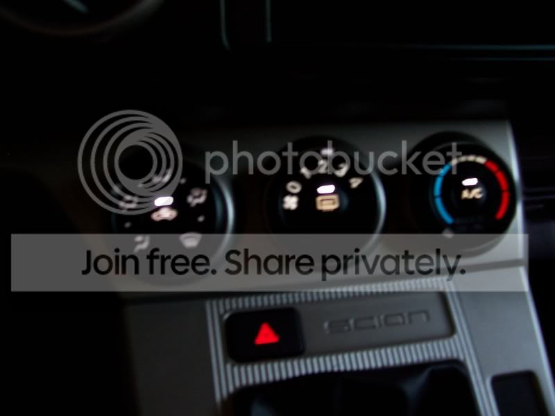

I used 3mm LEDs in the center buttons to swap the amber ones out.
