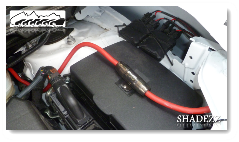

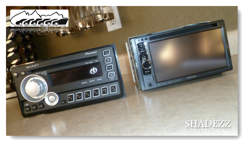

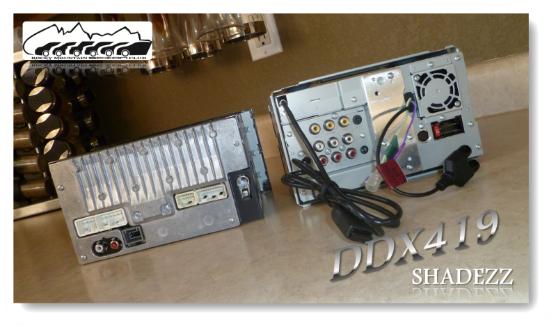

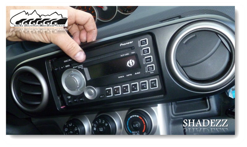

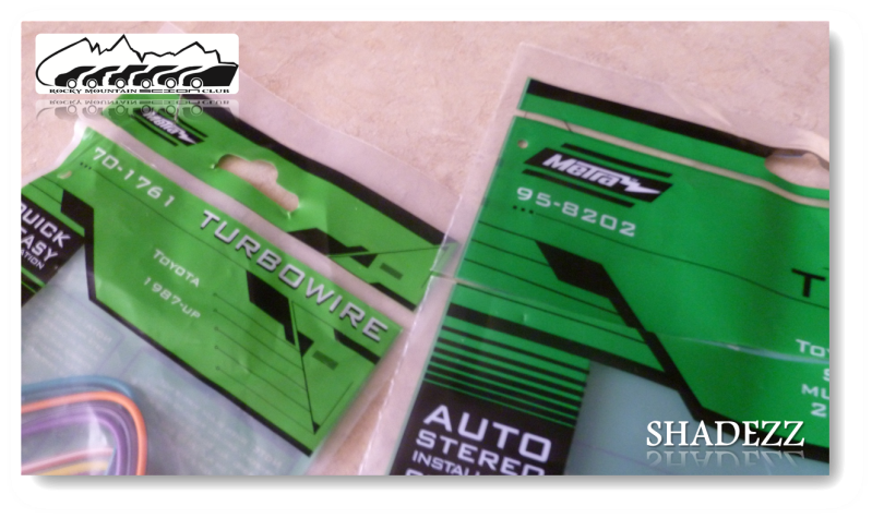

Well picked up a Kenwood new touch screen today!! I went with the DDX419 because of the b/t and the hook up he gave me. I was just going to buy the DDX319 but I'll take the upgrade for $60.00!! Even the DDX319 is a great deck for the money!!
DDX319...$299.00
DDX419...$419.00 (Got it today 360.00 + tax new) Sweet Deal at Quality Audio sound Thornton, Co!!!

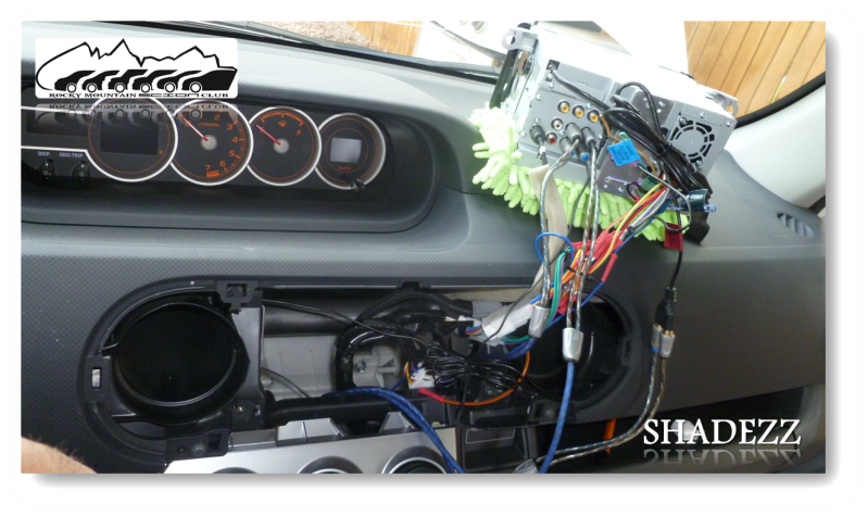

Install was easy as could be.....Pics should do it justice on the DIY

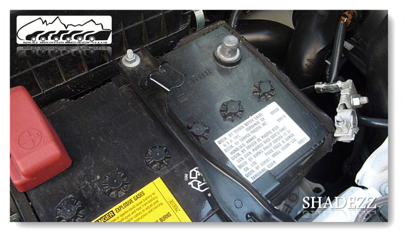

Stereo Bolts(4) are 10mm, same for the ground (Battery -)
(Q: How do I run DVD while I'm moving or bye pass the dvd parking brake function?....(A: Ground the parking brake wire)

I know you have to ground the parking break wire but which one is it? Does it come off the deck?

Yes it is on the back of the deck labled Prk Brake(light green).....Just ground either to black - or to a correct ground.

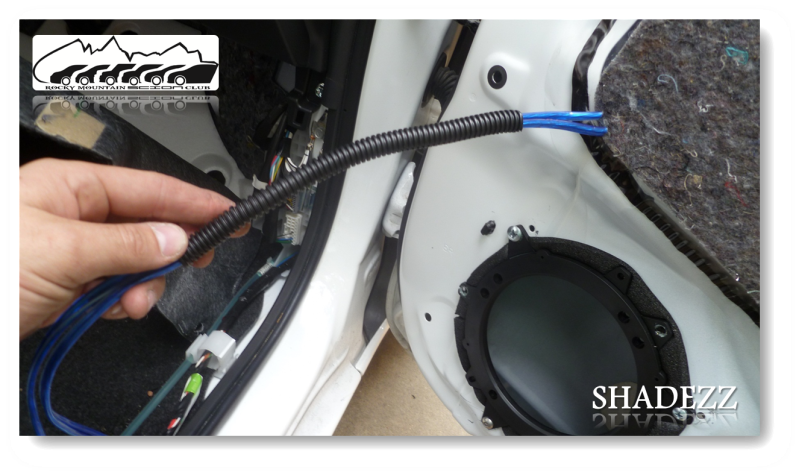

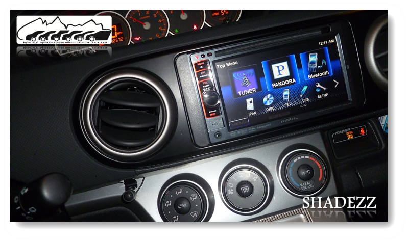

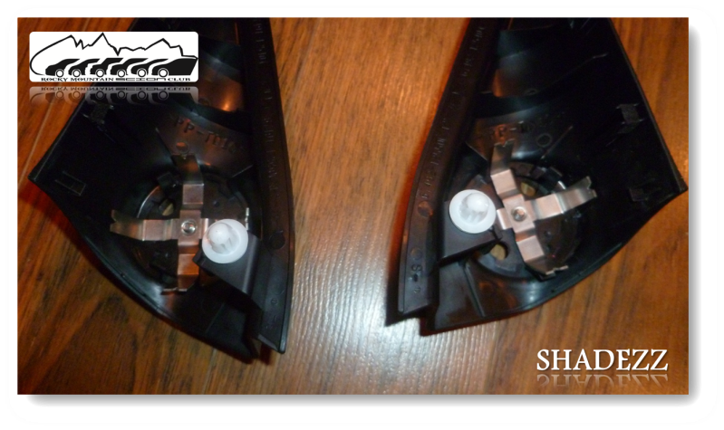

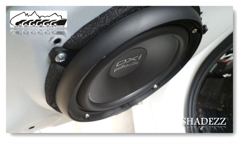

Some more of the install...

Buy everything from best buy?
Sweet setup. But the grills on the speakers is not necessary when mounted inside the door panel.
Good work though. Most diy installations I see in my shop don't look anywhere near as good as this does.
Old Jun 8, 2012 | 02:54 PM
Shadezz's Avatar
Joined: Jul 2011
Posts: 1,031
From: Northglenn, Colorado
DDX419- Quality Auto Sound
Kicker amp 4 gauge- Best Buy
Kicker RCA's (3 sets)- Quality Auto Sound
DXI 6500- Best Buy
14 Gauge Speaker Wire(100ft)- Walmart
Alpine V60- Car Toys
As for the grills in the doors it does make a difference because the added depth along with foam surround on the inside of the door makes the sound not get lost between the two. All the other cars I've done never had the room, but scion xbs do!!!

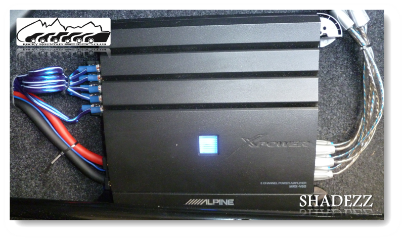

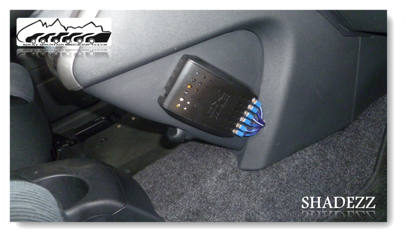

A few amps & Sub shots...getting ready to build a custom box and amp rack..
