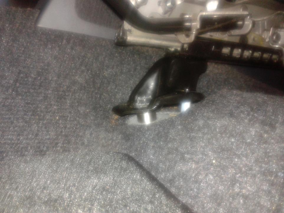

When I purchased my XB I noticed that the seats were a little flat for my taste. I could lower the back part of the seat but I felt like the front edge of the seat needed to be raised a little. So I turned some 3/4" dia spacers 3/8" long and put them under the front seat mounts to give the seat some more tilt in it. This accomplished what I was looking for. Now I feel the seats are way more comfy. Just thought I would pass this along. This is something that is really easy to do.
