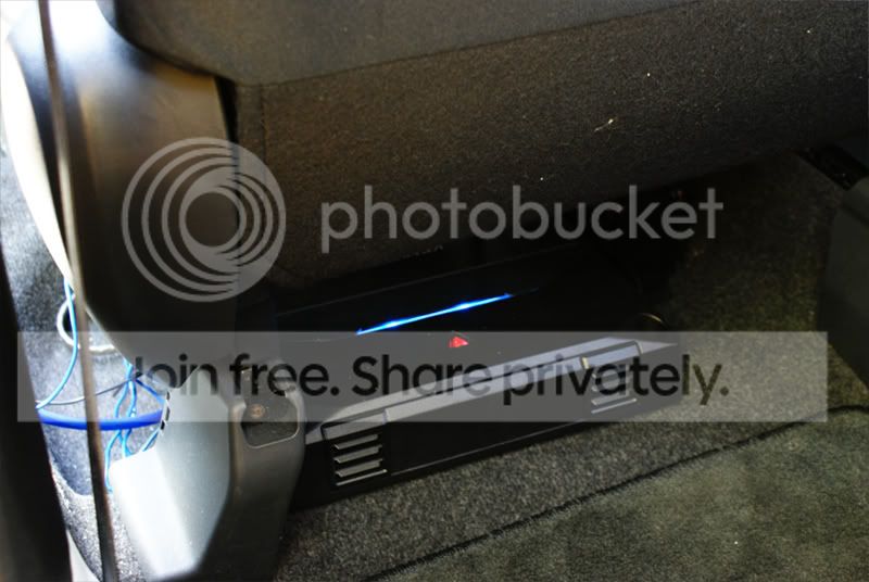

after working on building the custom box inspired by whiteymarvin's design, i finally am done with the set-up. i just needed a little more kick to the stock system. gotta love it.
heres my passenger seat sub. ive been too lazy to carpet it, soon enough lol.
kenwood kfc-w2551
kenwood kac-8104d 300w mono amp
also, heres a clip on how it sounds inside the car.
hope you guys like it!

looks pretty good! do you mind posting up any more pics you might have or the dimensions of the box? i was looking into building an under the seat or a custom glass rear pocket. id prefer an under the seat as the build will be a lot easier! thanks.

looks like a real nice fit... you should throw some pics up of the box out from under the seat so we can see the whole thing

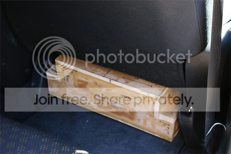

Most definitely. I'll take more pictures as soon as I can with the box pulled out. I still haven't had the time to carpet it yet lol.
As for tim_rs6, the dimensions are:
The Pieces
Bottom - 9x15
Front Bottom Riser - 3.5x15
Back Bottom Riser - 1x15 (use 3/4 for strength)
Back Bottom - 4.5x15
Back - 4.5x15 - 2x2.5 top corners
Front Bottom - 5x12
Top - 18x12
Front - 2.5x11
Upper Sides - 2.5x18 x2
Side Tops - 1.5x13 x2 (use 3/4 if you want)
Lower Sides - 3.5x12 - 1.5x4 bottom corner x2
1/2" MDF Box
HxWxD (Internal)
2.5x11x17 = 467.5 - Top Section
3.5x14x7.75 = 379.75 - Bottom Front
2x14x4.25 = 119 - Bottom Rear
966/1728=0.559 cubic feet
You can check all the info at this POST
Also, heres a link for the 3d model of the box via Google Sketch. MODEL
This is all thanks to whiteymarvin. Heh.
