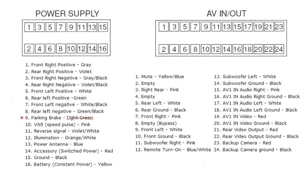

anybody succesful doing the dvd bypass if so how did you do it? i been looking on avic411 but they say the color of wires are different on our head units
I did mine, and yes, our parking brake wire is a different color. I will try and find my notes.

I could not find my notes about the RS6 Emergency Brake wire color, but I did find the Pin-Out diagram that I used to locate the wire.
