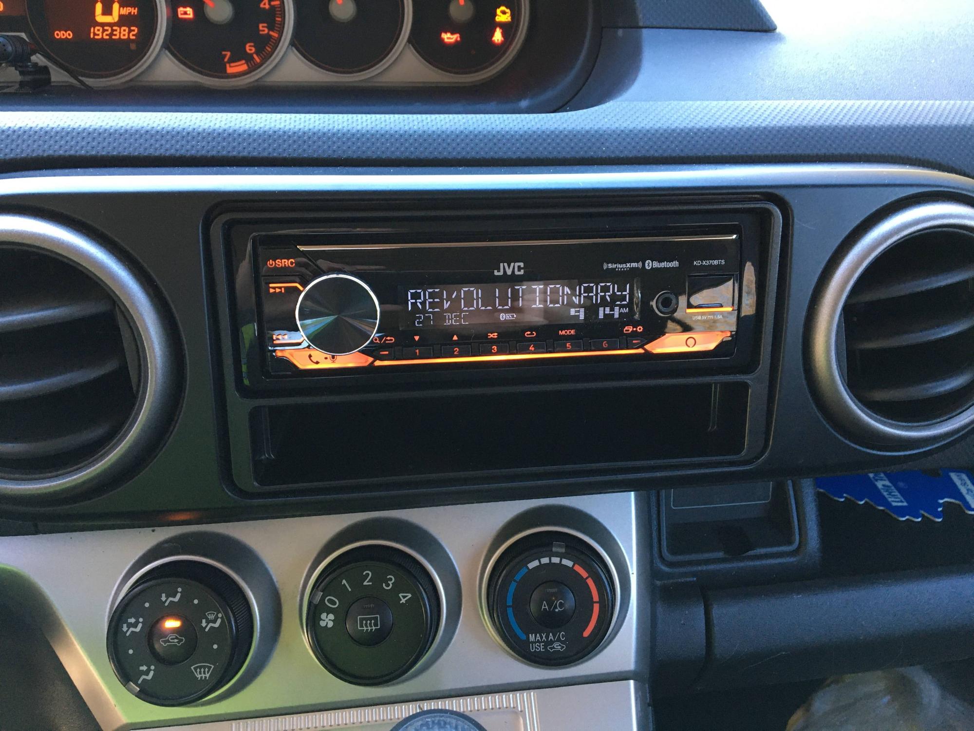

Finally got around to pics of the install. I went with the following:
JVC KD-X370BTS head unit
Metra 99-8257 dash kit
Metra 70-1761 wiring harness
Pioneer TS-G650 front door speakers (old ones were falling apart)
I had previously installed a Toyota Handsfree PT923-00111, but didn't like several things about how it operated with bluetooth, and the fact that it only played through the front speakers.
This deck works flawlessly with Bluetooth. Couldn't be more happier with it. Especially the ease of radio removal/installation -
compared to 5 years ago with the wife's old 2004 Monte Carlo which was a pain in the *** with all the dash work.
