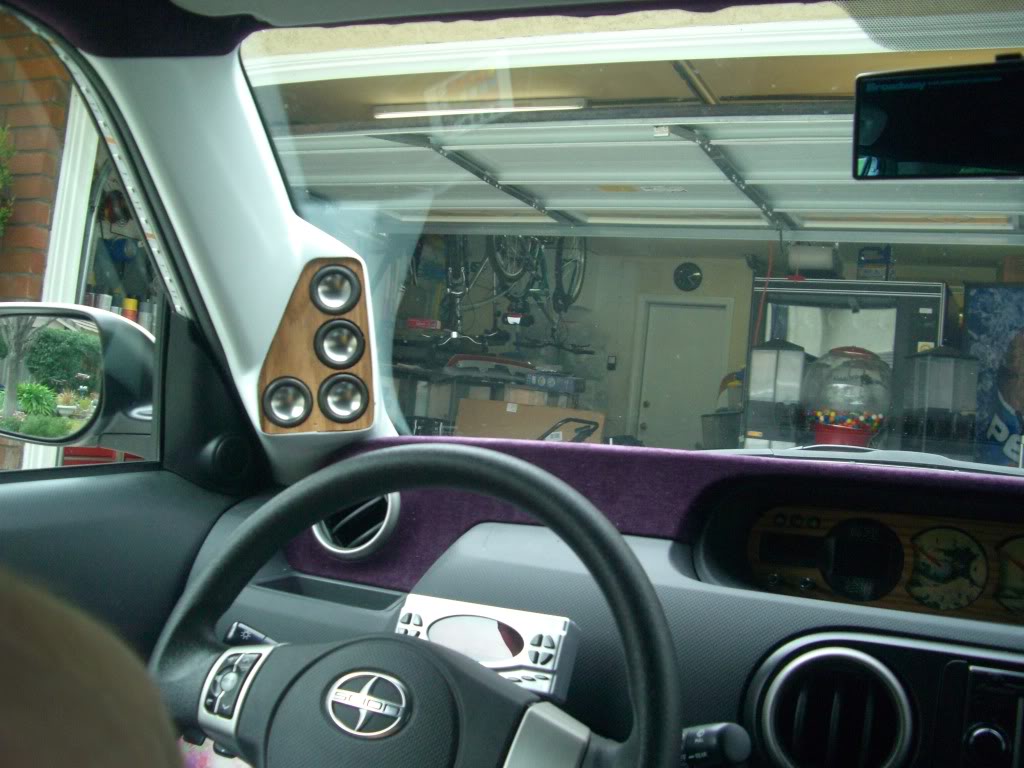

Yeah, the Shaker 500 system basically does what I described, having a mid and tweeter in the door with the sub mounted below.
I've actually done something very similar with the 8" mid-bass in the door, 4 2" full range speakers on the A-pillars and tweeter in the stock tweeter location.
Here is a pic of the full range and tweeter.
Don't have any pics of the 8s since it looks completely stock from the outside.
Like I said it's a lot of extra work for most people and you have to be more than slightly obsessed with sound quality to want to do it. Obviously I am.
