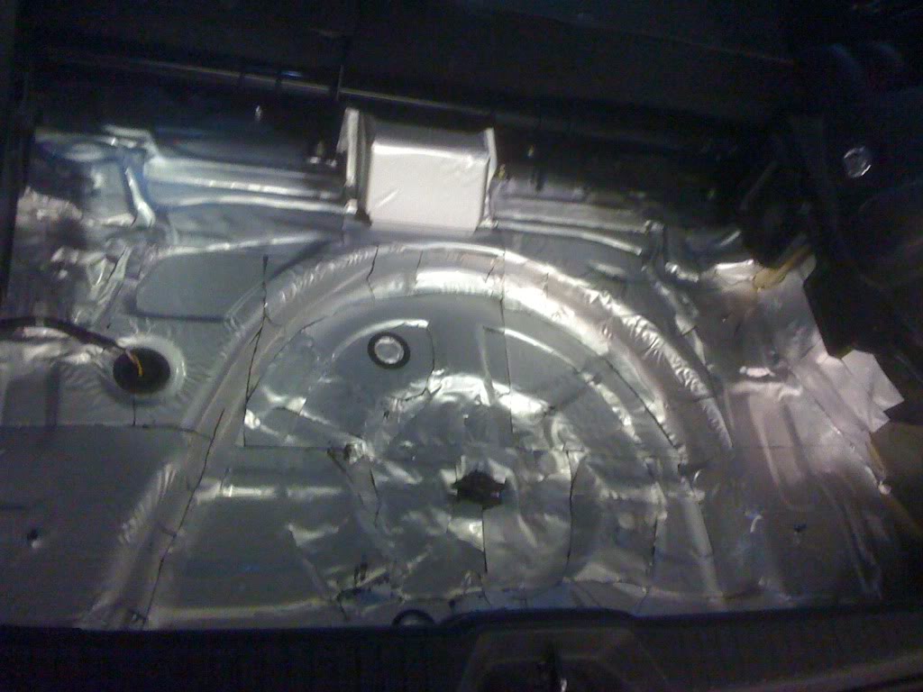

First step was to rip out the trunk and spare tire and lay down some sound deadener.
I chose to use edead 40 by Elemental Designs. Its not the best out there but I'm on a budget. Feel free to substitute your own preferred brand of sound block. Make sure you put it on when it is fairly warm out and don't leave any air bubbles underneath. This means you'll have to cut slits in it all around bumps and curves.

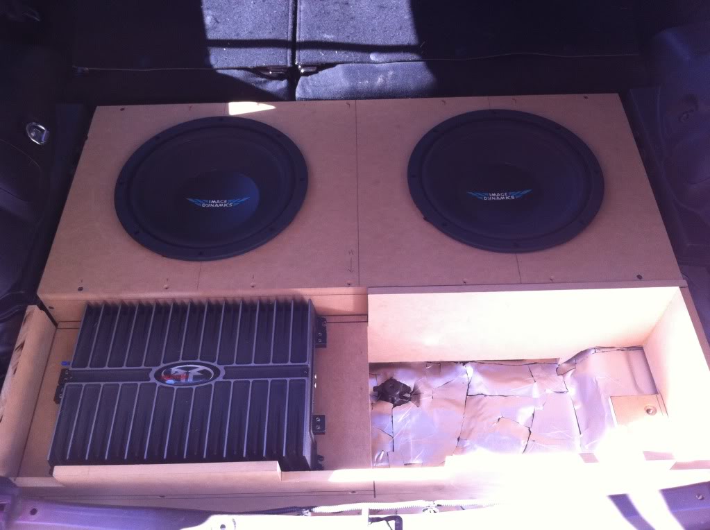

Then I decided to build the amp rack on the furthest back part of the trunk out of 1/2" MDF. I would make the sealed subwoofer box out of 3/4" MDF on the sides and top and use fiberglass on the bottom so that it conformed to the odd shape of the trunk floor.
Cutting out the wood to shape the floor was a little tricky so we used a piece of cardboard and just made little cuts here and there until we were able to get it to sit perfectly on the floor. Once that was done, we were able to use the cardboard as a template to cut out the MDF. Unfortunately I don't have any pics of the individual pieces of wood but this is what it looks like in the car:
As you can tell, my two amps are too wide to fit in there side by side, so I had to stagger them by mounting the Infiniti on the bottom and the Rockford Fosgate on a raised platform.

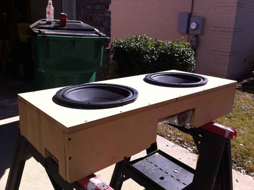

After it dried over night, we removed the box from the trunk and attempted to pull off as much foil from the bottom as possible. Then we cut out the top of the sub box from another sheet of 3/4" MDF and mounted it onto the box and gave the entire thing a good sealing with silicone.
Then it was time to cut the holes and being on a budget, I didn't buy a $50 circle jig. Instead I made one out of some spare 1/4" MDF and it worked out pretty well! See for yourself:

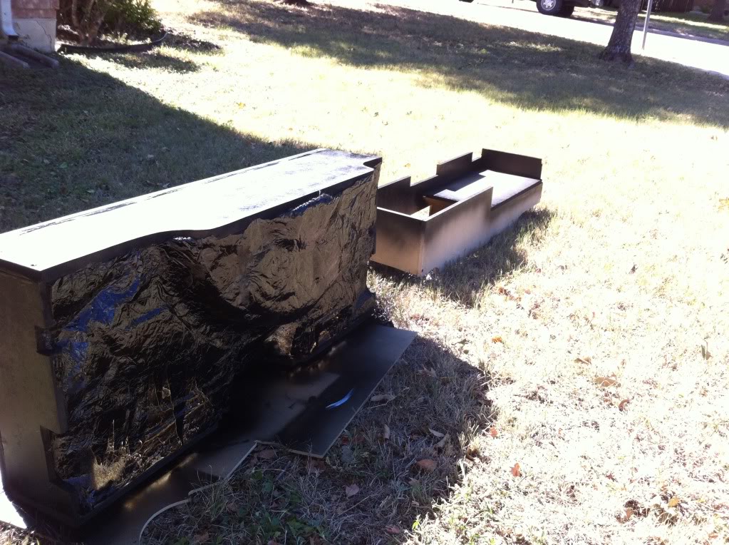

Put it back in the car for a quick fitting test. We found that for an easier ingress/egress of the box we would have to shave about 1/2" off of the plastic slots on the side interior panels with a Dremel.
Then we ripped everything out and gave it a quick paint job in black just as a precaution. We will cover some of it in black carpet later and of course there will also be the overall cover piece that sits on top of it all.
Next we covered the inside of the amp rack with black carpet using 3M spray glue. I know you can't see it in these pics very well but its on there. We also started mounting the amps and running the wires/cables to them.
Now we drop the sub box back in, wire it up and give it a test run!
This is where I've left off. Its functional but not finished yet. Unfortunately the holidays have made me even more broke so it might be a few more weeks until I can cut out and finish the cover piece.
