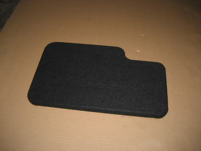

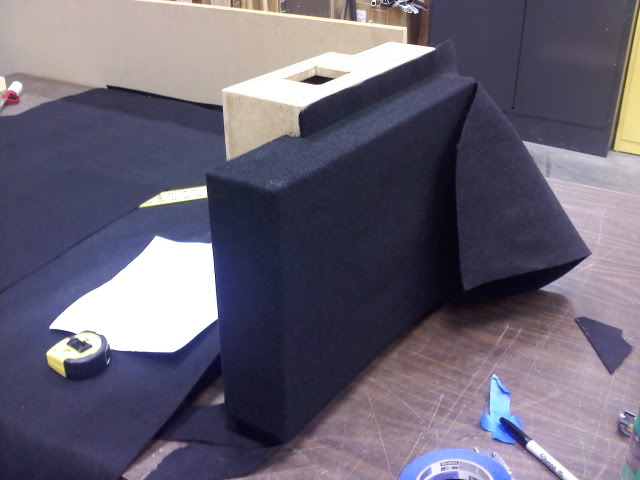

I decided to make a under the seat sub.

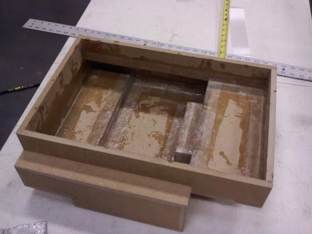

I fiberglassed the inside

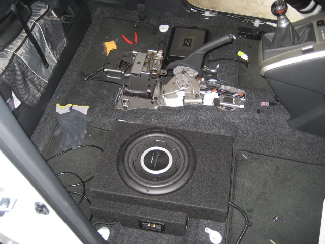

I installed the sub last week. Install was a success!

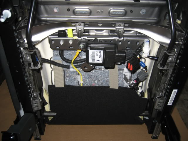

First i modded the pass. seat.
before:

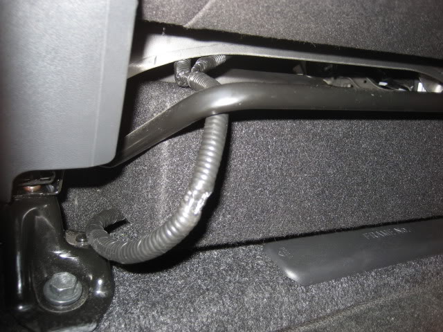

after removing the bracket and moving the wires:
Sub

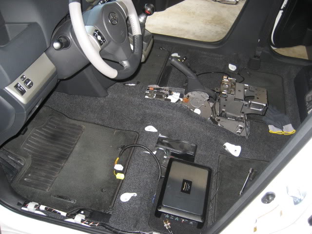

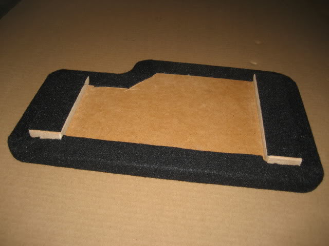

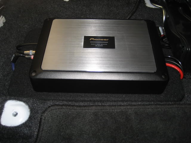

I made a board to mount the amp

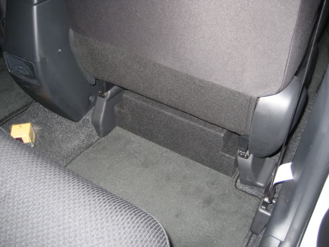

sub in place
it was a really tight fit for the sub box, but everything clears the box.
It sounds great!

Looks awesome!!! Nice and clean! you got some skills, i love the amp mount do you have dimensions? i want to do the same thing maybe with plexi glass, it makes it 10x cleaner!!!! maaad props dude!

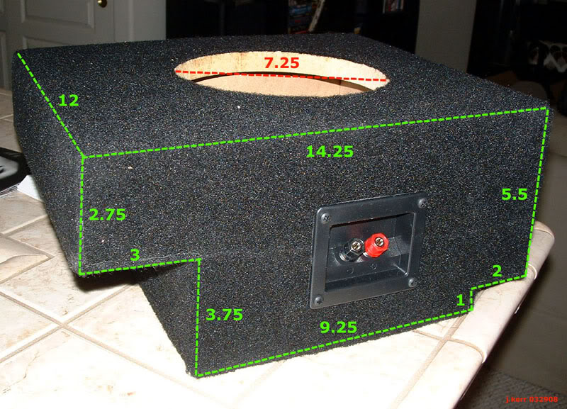

Really nice job! It's cool to see the evolution of my original design becoming recreated again! I almost want to have another made to these specs. What's the volume of this box? If I remember correctly, mine is 0.31 ft^3.
