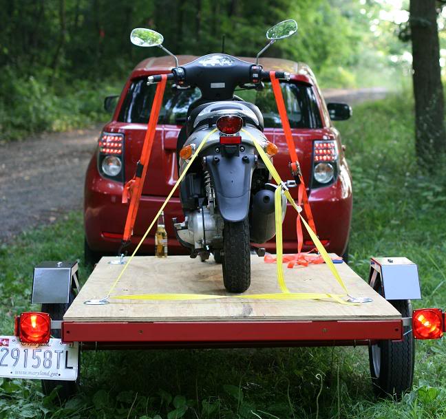

Please be cautious with your hitch tongue weight/towing capacities! Just because a hitch has class related ratings does NOT mean your vehicle is capable to max the hitches rating. I have towed with many vehicles over the years, I don't claim to be an expert speaking either. Consider the advice from your owners manual (not a qoute, just from memory) your vehicle is not recommended for towing OR bicycle carriers. If I shouldn't put my bike rack on it, should I load to tongue weight or towing capacity? I don't think so. I carry my bikes and tow my trailer, and feel for the vehicles "attitude" while doing same. Aside from the braking issues tranny/motor stress is important too. I typically never tow a heavier load in the overdrive or top gear of my vehicles. Using the platform/wheelchair as an example I would never do that, but to tow that weight would be fine.
jobdesigns, Toyota does not rate any of their cars for towing in the US. The reason is that Americans are lawsuit-happy. They don't want anything falling off the back of a car (bike rack, trailer, etc.) that could cause damage or injury that they might be liable for. If you look at the same cars in other countries, they are rated to tow. For instance, the xD manual says the same thing about not towing anything... but in England, they rate it to tow 1,900 pounds. Frivolous lawsuits basically don't happen in the UK.
In Europe, they'd be hard pressed to sell a small car that isn't rated to tow. When I was in the Czech Republic a few months ago, I counted the trailer hitches and one out of every four cars on average had a trailer hitch. Their hitches are for trailers only, not bike racks. I saw many people towing small trailers with subcompact cars... including ones with 1.1 to 1.4 liter engines (less than 100hp).
In the US, people think they need a truck to tow a 1,000 pound trailer... and the car companies don't want them to know otherwise! I tow all the time with my xD. The heaviest load I had was about 1,600 pounds. That was an enclosed 4x8 Uhaul trailer filled with furniture and books. It towed this load with no problems. Braking wasn't an issue. I had to downshift to 4th a few times on long uphill grades... but that was in the hills in PA.
It is perfectly legal to tow, so long as you have the right equipment and watch your state's laws regarding brakes. In Maryland, a trailer doesn't need brakes unless it is over 3,000 pounds (which is more than I'd tow with my xD, anyway). It is also perfectly safe to tow up to the hitch's rating. Just keep in mind the leverage that a cargo rack or bike rack puts on the hitch. If your tongue rating is 300 pounds, you can have a trailer with a 250 pound tongue rating and you're okay... however, if you have a scooter rack that weighs 50 pounds and a 200 pound scooter, you may be over the limit because of the amount of leverage with the scooter a foot or more behind the receiver.
