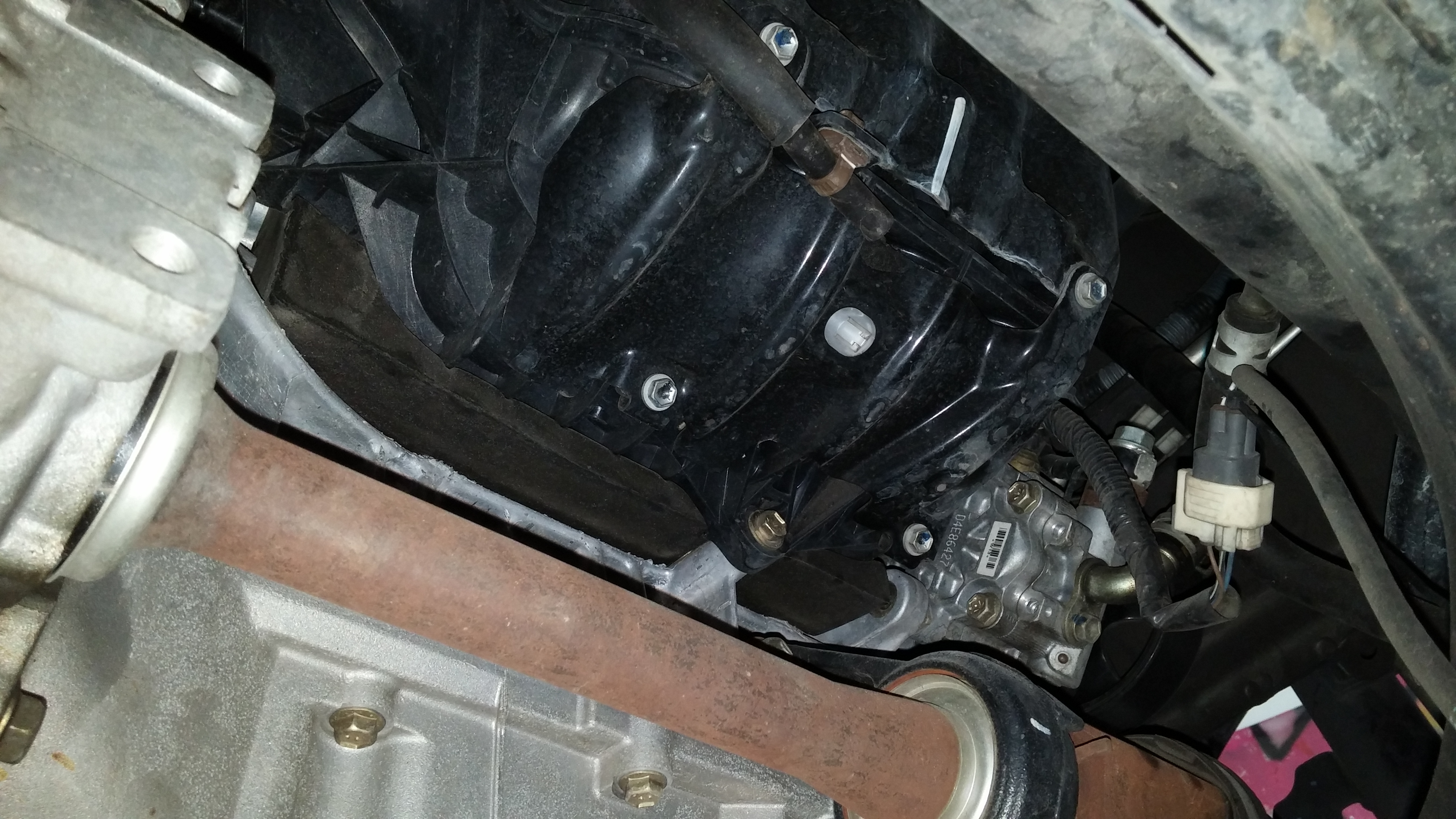

That particular idler pulley isn't too horrible to get to. It is located on the back lower passenger side of the engine, where the power steering pump would be if we didn't have electric power steering.
If you look at the picture I've attached you can see the power steering pump on this Camry engine. That is where the idler pulley and bracket are located looking up from under the vehicle. Right above the intermediate shaft for the passenger side drive axle.
