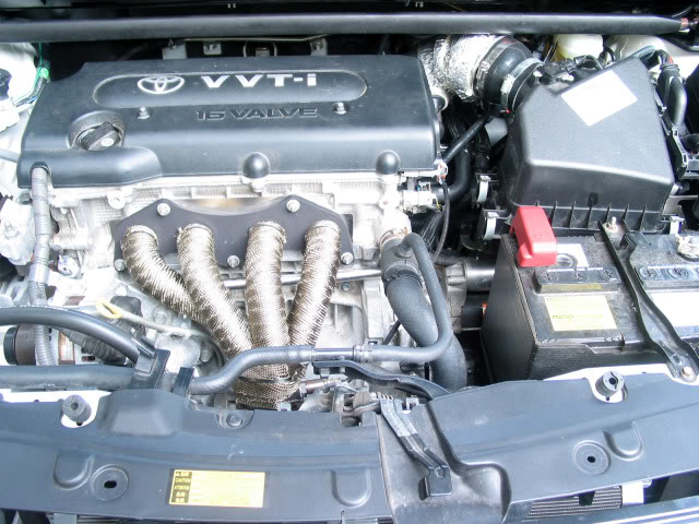

Well, well! Just having one of the warmest days around here for awhile and while stopped awaiting a light change (just like last time) I once again got a CEL on coil-pack three and the engine began stumbling. The misbehavior cleared shortly before the light changed, but I did feel another stumble while gathering speed. Seems pretty clear heat's the trigger for the problem (while cooler outside or the vehicle is moving, the engine compartment temp is lower and the failure doesn't occur). Don't know if it's specific to that particular coil-pack or that above-the-vertical-pipes location, but I do know the problem never occurred before wrapping the header verticals leaving the upper singles unwrapped. Looks like it's time to install the upper header wrap and see if it reoccurs.
I copied down the pertinent OBDII freeze frame data so if it happens again, I can look for any interesting differences -- though given it occurs during idle, I doubt the readings would change much.
Old Sep 11, 2011 | 02:12 AM
TrevorS's Avatar
Posts: 2,778
From: DE
Goes in Sunday, here's hoping the CEL doesn't repeat.

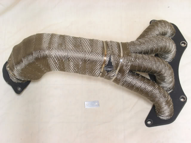

Old Sep 11, 2011 | 10:02 PM
TrevorS's Avatar
Posts: 2,778
From: DE
Took a lunch run with the fully wrapped header and on getting back immediately popped the hood to check engine compartment temp -- way cooler! Guess I could always be surprised, but I'm expecting that CEL to be history !

Old Sep 13, 2011 | 05:03 AM
ScionFred's Avatar
Posts: 3,387
From: Baltimore, MD, USA
The CEL will be back, just give it time.
On a more positive note, the newly wrapped header looks great and should perform better than the previous partial wrap.

You're a hard task master Fred ! Still, no question I'll be disappointed if it occurs again, however, if it does, next step will be to swap the #1 with the #3 coil pack and again cross my fingers ! Should there be another failure, it may well not be until neighborhood June of 2012.

Sorry Trevor but I call 'em as I see 'em and even a "way cooler" reduction in subjectively perceived underhood air temp after performing a mod subjectively expected to make a big improvement is not likely to revive a failing coil pack, IMO. I could be wrong of course and I do hope that this extra header wrap somehow helps but I doubt it will.
