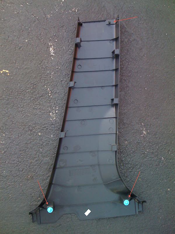

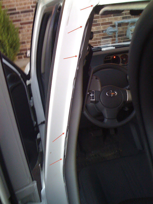

Ok. First pull the plastic door sills up in the front and rear (sorry no pics). They're easy to get off, there's just 2 clips each, one at the front and back. Then pull the rubber away from the B pillar. The bottom piece of trim (black) comes off first with 3 clips (red arrows).

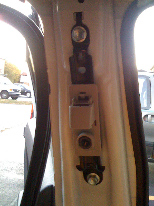

Then remove the little cover over the seat belt height adjuster by pulling out at the bottom and squeezing the sides together. It should just tilt up and out.
Unbolt the seat belt holder

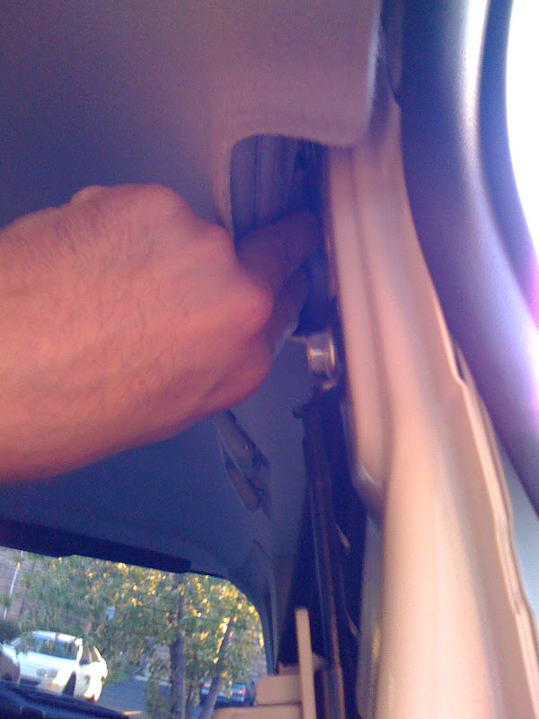

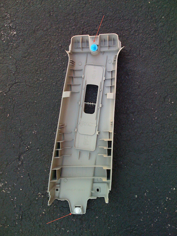

You can now pull off the top piece of trim (gray). Just pull out from the bottom. There's 2 clips.

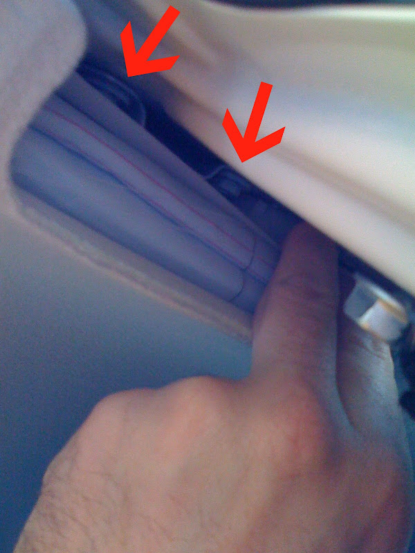

At this point, you can just see the bolts that people have been reporting loose. They're up and under the airbag. You'll need to stick your fingers up there to access them. Use a 10mm wrench to tighten them.

I drove around and realized that nothing had changed, so I pulled over and removed, sprayed, and reinstalled the seat belt bracket.

I have this exact same issue with my 2010 xb. Thanks for the photos. Let us know if this fixed it for good too. Thanks!

I'm glad my pics could be helpful. It's always nice when I find pics of exactly what I'm looking for, so I figured I'd start taking pictures and posting everything I do.
Its been a month now, and I've drivin a lot since I did the above work. I can confidently say I got rid of the clicking sound. Again, I'm not positive that it was the seat belt bracket, as I only gave my first fix (WD40 in all the seams) about 2 trips around the block before trying the seat belt bracket. It sure seems like it though. If anyone else does this, I suggest removing, lubricating, and reinstalling the seat belt bracket first to see if this is all you need. It's really easy.
