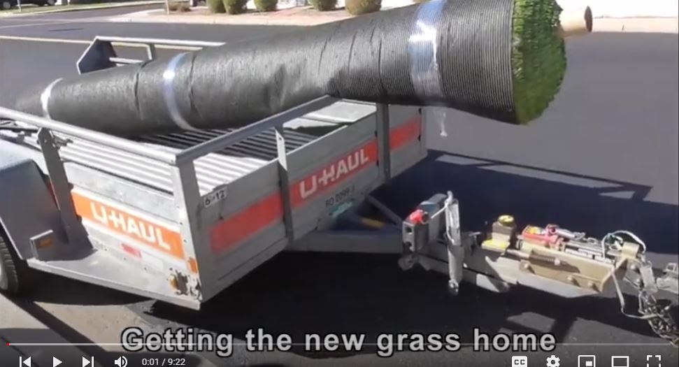

I have done a little bit of towing and can confirm that the extra load wears the discs down pretty quick. Replaced front discs and pads at 35K miles, then need to tow reduced, so brakes are going further.
No plans to upgrade.
This is the heaviest load I've towed - there were 2 similar sized rolls to start with and the trailer itself is very heavy. One Uhaul store wouldn't rent me this trailer, but another did (obviously) and it's nice when the trailer brakes work. They didn't on a previous rental.

The trailer in the pic weighs 1730 lbs https://www.uhaul.com/Trailers/6x12-...ler-Rental/RO/
The fake grass in it was probably 400-600 lbs.
Without the trailer brakes it was hard to stop, the wheels spun easily on accel from a stop light too. I just took it easy and allowed for long braking distances.
Perhaps the trailer and boat companies list the weights, to give you an idea about the total weight.
I rented these trailers a lot https://www.uhaul.com/Trailers/5x8-C...ler-Rental/AV/ , schlepping stuff to and from college for my daughter. Lighter, but they wore out the brakes early.
Just bought replacement discs and pads from rock auto when the brakes got crunchy. Bendix parts.
