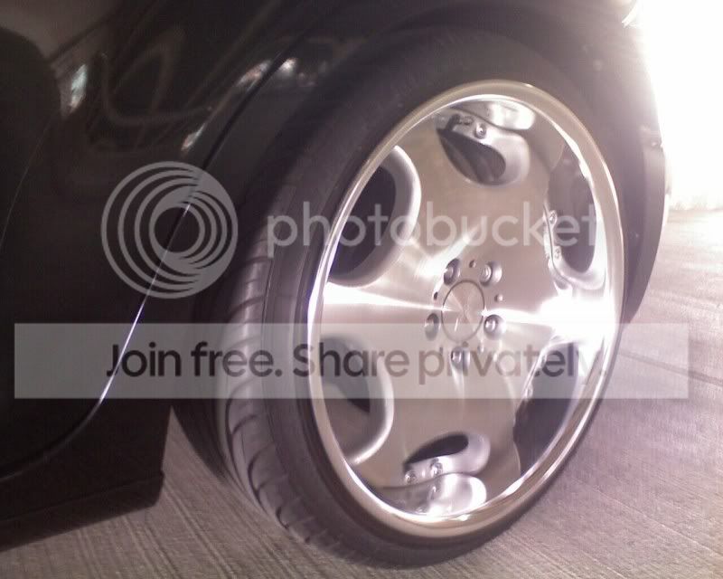

Old Apr 1, 2008 | 11:34 AM
scion619's Avatar
Posts: 661
From: San Diego 619
actually my fronts are really not that stretched and the backs are some what of a very conservative stretch .....here is a pic of the backs....
