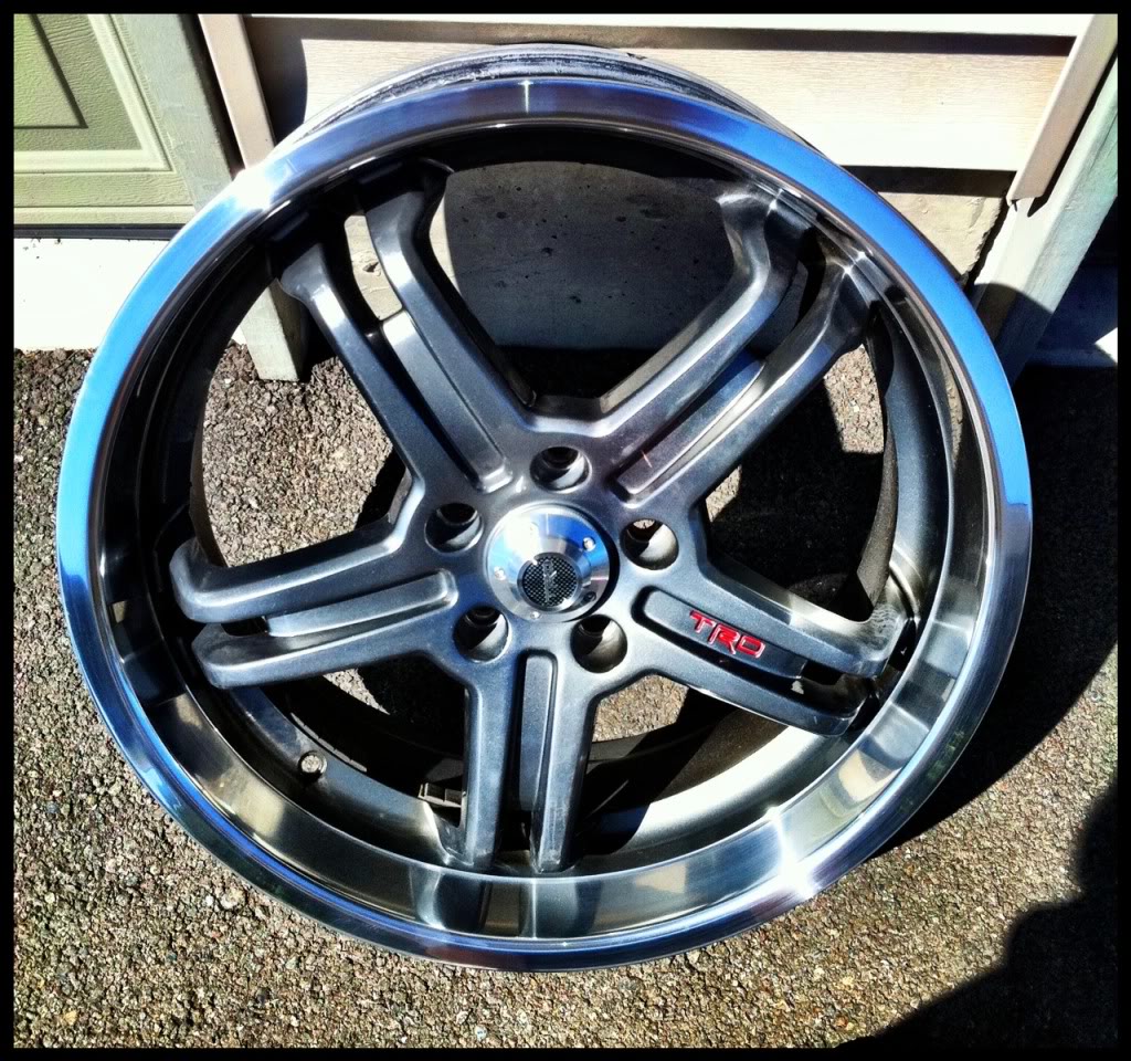

I never thought about doing that.....looks sick bud. I didnt like my lips so I sanded and had them polished to a mirror shine it made a huge difference, but I'm kinda thinking I want to go with a another look so I'll prob let someone else take them off my hands.....kinda thinking about going the other direction and maybe some 16's

Holy crap! More info on the polish!

xseveredveganx it took me almost a day a wheel to sand them I made a jig and used a hand drill to adapt them on. I can control the speed via the pressure I use with the sand paper. The TRD wheels come with a thick coat of clear so its no fast process. I then stepped my sand paper all the way to 1500 I could go further but I like the way they look now and if I want to I can just hit them with some polish anytime and they come right back. I'm looking to go to maybe some 17's or even 16's now so these need to find a new home.

They look good.
F.Y.I
You can always use JB Weld to fill in curb rash
