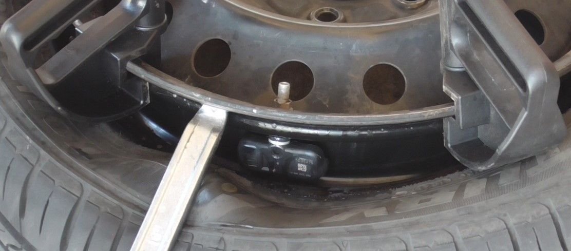

Anybody know of a good, cheap tpms scan tool that's scion compatible? I had new sensors installed but the shop didn't do the relearning process. They just installed the sensors. My dash light still blinks/ then goes solid after a few minutes.
Old Oct 27, 2023 | 09:31 PM
RichBinAZ's Avatar
Posts: 802
From: Mesa, AZ USA
The shop was supposed to register your new TPMS's with the car as part of the process.
The
cost of one of those tools cost of one of those tools
is the reason I am now trying to replace the batteries in our original set. With no change in reg numbers, the computer should recognize them and I should just be able to do a reset???
I ordered the
batteries thru amazon batteries thru amazon
, but they will take a long time to get here - 3 to 5 weeks - so they are probably coming from China or Japan or ????
EDIT: See post #15 below for the correct battery
The CR2450 batteries are a slightly different chemistry to the BR2450's. Which gives a slightly higher temperature capability I think... 60C vs 125C. Hope that is enough. 60C is 140F.
Just realized a bit late, that I could have got them from Mouser dot com. Though the tabs may not be right.
The housing says Pacific - Made in Japan : The label with the green writing on it says Pacific - Mexico. So who knows were the parts came from...
In the meantime I took one out and dismantled it to see how hard it would be. Replaced the valve stem in the tire with a non TPMS one so the XB can still be driven.
Here is the TPMS taken apart. The white RTV came off easy and I used the "lift and peel technique" to remove the tabs from the battery before trying to lever out the circuit board.
Didn't want to risk shorting the board somehow.
Little more cleanup to do, but not much. Just need to clean around where the battery tabs are soldered to the circuit board
The plan from here is to de-solder the old tabs, then solder in the new tabs - Piece of cake right???
Re-pot it and replace it. Then do the same with the other 3

Wow, it actually worked - swapping out the old TPMS batteries for new ones.
I was not sure it would, as I'm not that good with the soldering iron.
But after re-installing everything and doing a reset it went from...
...To
About a minute after turning the ignition on, in trip A mode, while holding the reset button up for 5 seconds
Drove it for a few miles and the light has stayed off.
