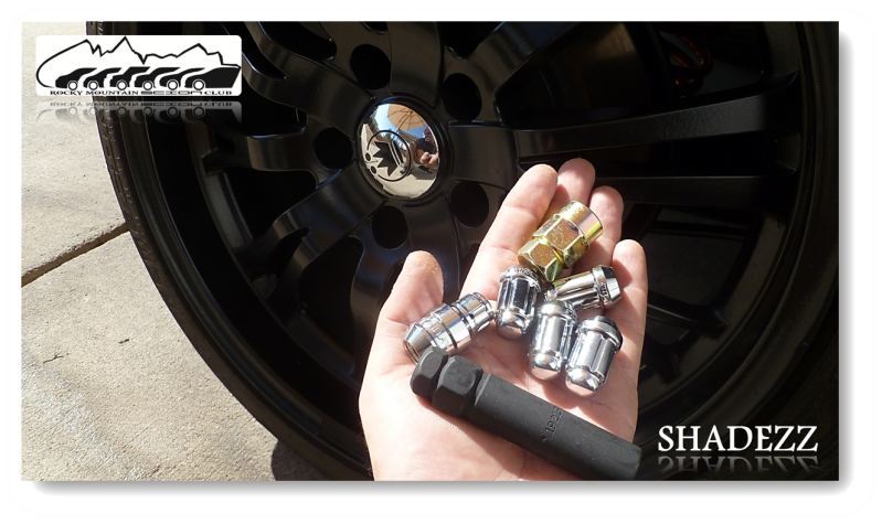

My first set of gorilla lugz from discount laster 7 years and just replaced them last week cause the key lock one started to wear so I almost could'nt get it off....didnt want to risk that so went ahead and got a new set. I've never had issues with them coming loose so I think mine fit and have enough thread. I think the cost was 22.00
