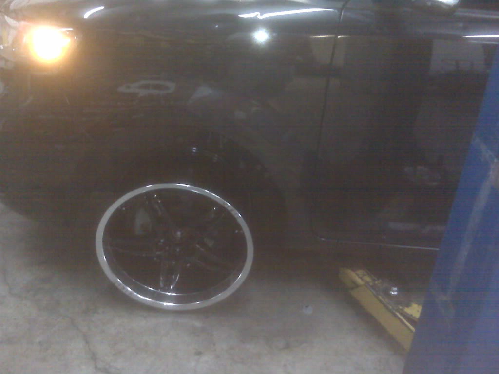

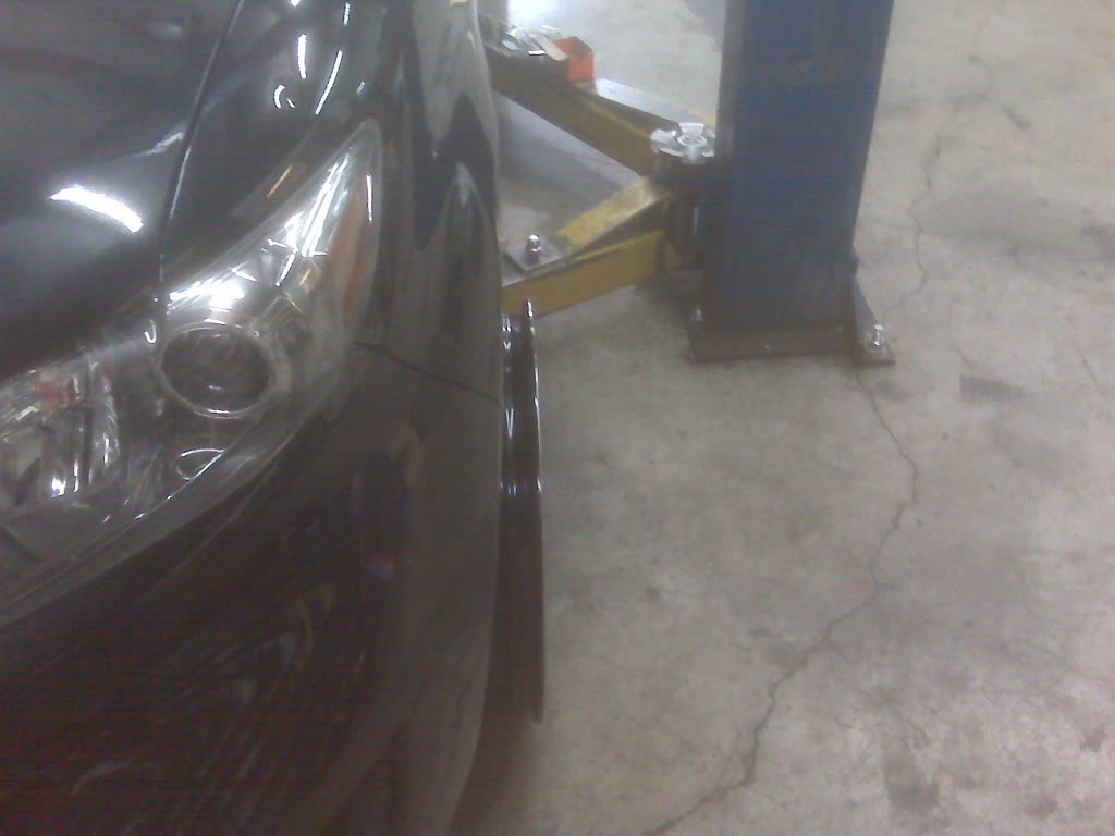

I have 19x10 +25 pics from a mockup we did before I ordered a set of 35's for the front. without tires at stock height it clears everything just fine. That is of course with a 225/35/19.

this is 19x10 +25 all around. I later decided +35 for the front would be better as I had room for it.
sorry for the quality - it was a blackberry and yes those are dents. I have a SEVERELY hail damaged XB - it makes it easier to do crazy stuff if the car is paid for and already damaged. LOL

I have not as of yet. I will keep it updated though, as there is plenty of room with a 25 to clear the shock.

The thing im worried about is if you camber the wheel because I wouldnt want that much poke in the front would it still clear with -3. +35 compared to +25 is less then an 1.00" more back spacing. and -3 camber is going to bring that lip a lot closer. Keep us updated!
