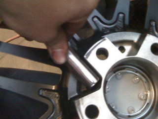

so i installed my axis apex rims today. and it seemed that everything was fine. HOWEVER
after they put on the fronts, they tried the rears and THEY DID NOT FIT!
it appears that the offset and something near the middle of the rim is rubbing against the caliper. it would fit on the car itself, but it would not spin because it was hitting the rear calipers.
you can see where his finger is. that part is not in the front rim at all. just in the rears. that is what is hitting the caliper.
that 5 star looking design is that part that is not in the fronts
the guys at the tire shop then switched it and put the fronts on the rear and the rears on the front and that worked. I'm sure that the people at axis did not mean for this because it looks ridiculous. so now i'm riding with the 4" lip in the front and the 2.75" lip in the back. it makes me wonder why the ppl at axis didn't mention this because they need to put a disclaimer out there!
it appears that i need spacers for the rear. and after measuring the difference between the front rim and rear rim, the difference of the metal is about 18mm. i'm guessing a 15 mm spacer will be fine.

i found these. but i'm really struggling which ones i need. 10mm or 15mm. the metal piece is 18mm extra from the fronts, but i really don't think that it is 18mm rubbing into the calipers. i'm unsure how much clearance i need. hard to ballpark.

I sent you a PM, but I'm not sure if you might rub tire/fender by adding a 15mm spacer to a +35 offset wheel. If you think you can get away with 10mm spacers, then go with the Ichiba v1 (the v2 isn't available in 10mm).

15mm will push out the wheels 5/8" and you shouldn't rub at stock height, but I can't say the same when you drop it. If you only need about 6mm, I'd go with the 10mm spacers, but it's your decision.

Looking at the backside of your wheels, the stock lug bolts should sit in the recesses b/w the wheels' mounting holes (where the guys finger is in the 1st pic) just fine. I see no need for any cutting. If 6mm is all the clearance you need, then there should be no need to shave the calipers either.

Yes, you will definitely need to use the longer bolts. The spacers will bolt onto the stock lugs, and the longer bolts will run through the spacers to bolt the wheels on.
