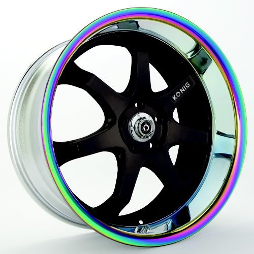

Konig After Burner

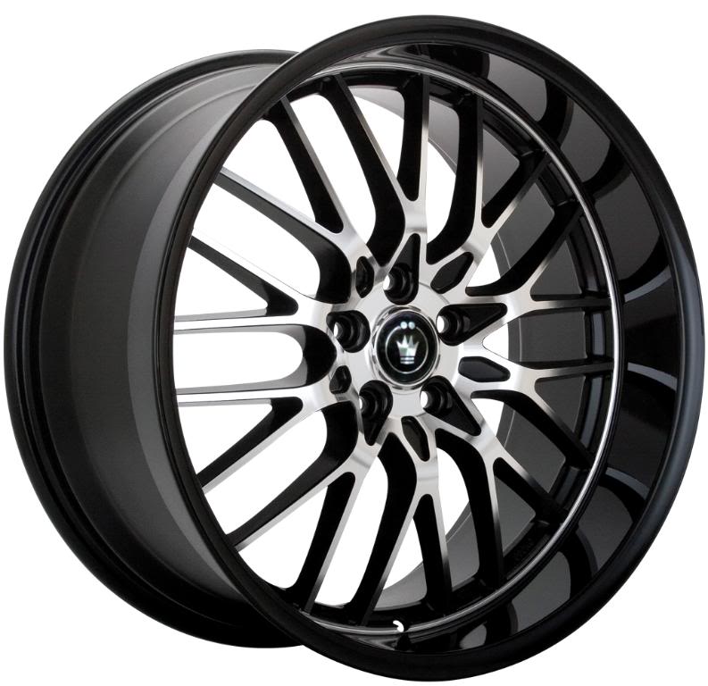

Konig Lace

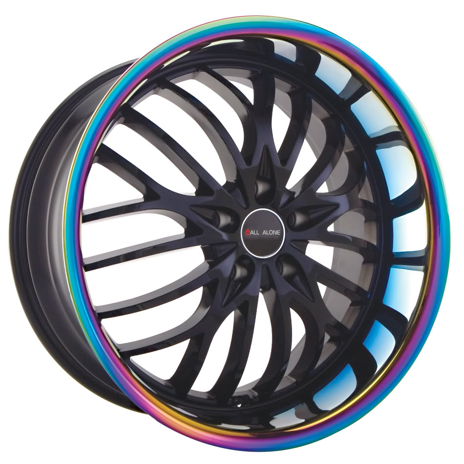

Konig All Alone

It's obviously your decision, but I'd stay away from the wheels with the iridescent "Prizma" lips. IMHO they're a fad that is too flashy, and when they go out of style your wheels will look dated. I think the Lace wheels would look great on a CSM xB2, and their style is much more timeless. I also think the mesh wheels help balance the look of the deep lips.

I'm likin' the All Alone.

Lace is nice but hard to keep clean, break dust, tar.......

Not yet, I was digging the right size of rims, but probably go with Konig Lace tho. I guess it's about 2" lips on 18x8 +35 and 2"1/2 lips on 18x9.5 +45, right? I don't understand about "brake caliper clearance problems", isn't just the tire push further out?

To understand what I'm talking about with brake caliper clearance, look at the spokes on the Tenzo GT-6's or the Konig Afterburners. The main center portion of the spokes is closer to the outer edge of the wheels, then angles back to join the hoop of the wheel. This allows plenty of clearance for the brake calipers behind the spokes. Wheels that have a much flatter face to the spokes or mesh (closer to the centerline of the wheels without as much angle or curvature) place that center portion of the wheel closer to the calipers.

You need to be carefull about the curve in the lace, or any style that has a fat return for offset ( wide lip ), as it will intefere with the caliper. In most cases a 5mm spacer will resolve the issue
