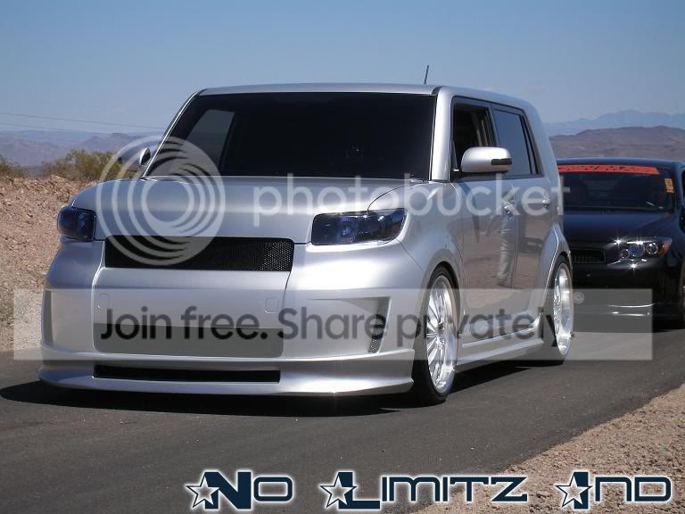

The fronts on NoLimitz' are 8.5" wide +38 offset:
