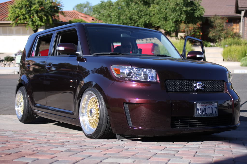

Default I'm Down & Out.... little poke little strech..
Alas!! they are on... Major rubbing still need to roll rears.... Privat Remember, 17x9 20mm 205-45-17 yokohama s-drives

looking good. what rims are those?

Edited!.. Privat Remember.

I'm not a fan of poke or stretch for my own daily driver, but that definitely looks good Darren.
Nice job.

Thanks! But Honestly, after driving it for 30 miles now.. I don't know WTF i was thinking, rubs like crazy, all i smell is burning rubber and no camber kits for the rear..LOL I love how it looks... it didn't look like it was going to rub that bad... oh well sometimes you gotta pay to play...

Just roll the rear fenders. The bolt on the bumper may need to be removed. That little ledge needs to be cut perpendicularlly to the body, then hammered out of the way.
I've done this once or twice.
Extend the rear shocks out a bit, too. May need to add bumpstops.

I ended up putting the bottom ring back on the rear coil and that did the job, rubbing is 90% gone.. but FMWG damnit.. so i'm just gonna wait until my buddy gets his fender roller back and try what xseveredveganx said to do.. I hope with some aggressive fender rolling I should be able to work something out..

I had to do what I said to my buddy's WRX and a friend's xB2. I still need to do mine. That little bumper mount just needs to be clearanced a bit.
For the front, you may want to pop the fender liners to the inside of the fender lip. Stock they're out and held in with clips, popping them to the inside will help a little with rubbing.

Car looks great! The cherry on gold looks super nice!!! How are the S-drives? Sound, handling and that type of thing? Any chance of driving them in cold weather yet?

Thanks.. well I've only had em on for a week.. so no.. and I'm in san diego, so I don't how much cold weather we'll be getting..:? So far they're great, pretty quiet.. they are loud on uneven pavement.. direzzas are much quieter, I drive slow as ____ so handling isn't really an issue... LOL.
Another 2 pics for the hell of it...

looks good man, how about spraying the centres like your hub caps?
that was a funky colour combo

looks good, try lowering the back more or stretching the tire so you wont rub

whats the offsets on the wheels?

Original post says:
17x9 20mm

just get a heat gun and small pipe and roll the fenders a little, you wont rub.
