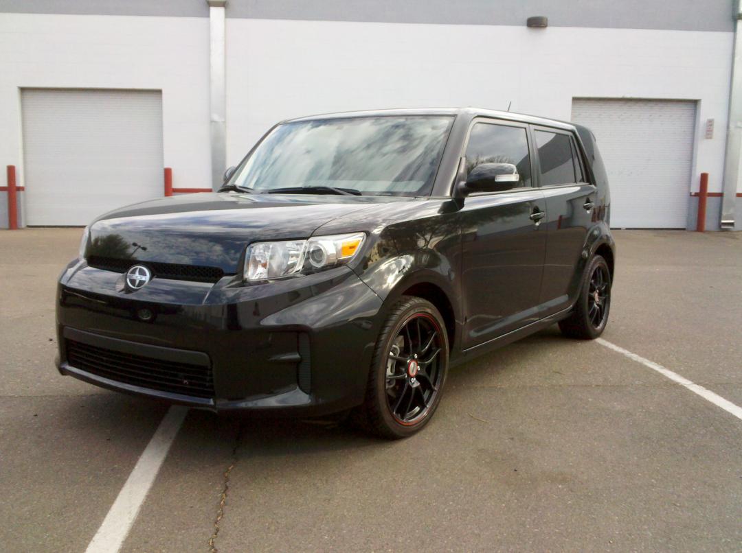

Got all my stuff in and finally bolted on the new wheels.

Wheels look good, now it's time to drop that bad boy.
