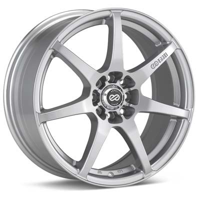

Enkei EV5 17x7 +38, 19.6 lbs

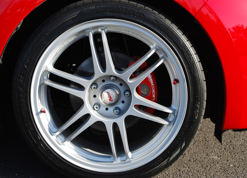

I forgot to include these Kosei K1 TS wheels. 17x7 +42, 14.1 lbs
I like these too but as with all of them, I can't tell what they really look like from Tire Rack's pics. One bright silver wheel looks like bright silver, another looks grey and another looks hyperblack. These silver Kosei's look almost white to me while the silver Enkei RS-M's look grey.

Regarding the TPMS sensors, any decent tire shop should be able to transfer them to the new rims as long as the new rims accept TPMS sensors (make sure you know which mounted rim goes on which corner). Although most do (Enkei for example), not all do. However, whomever you purchase your rims from should be able to tell you that. I think TPMS may be one of the search qualifiers at DiscountTireDirect and TireRack.
I went with 16" aftermarket for two reasons, I could continue to use my OE rubber, and it provides maximum rim protection from road hazards. Still, if your OE tires are pretty much done, 17" can't be too much worse than 16" in terms of risk, and they do make for a different appearance.

I'd say step up to the 17's for summer, and keep the steelies for dedicated winter tires.
All of those will work fine with 225/45 tires. With the wider 8" wheel & higher +48 offset of the Enkei Racing RS-M, I would suggest 235/45 tires for that one.
As Trevor said, wheel choice is very personal; all that matters is that you like them. My taste doesn't count, but I've always preferred 5/6/7-spoke wheels with wide spokes so my choice from above would be the Enkei EV5. I also think that the slightly darker finish and luster of the spokes combined with the polished lip give it a nice rich look that would compliment the NBM color quite nicely.
When I had my tires & wheels installed at America's Tire Co. (Discount Tire) they swapped the sensors for free, but there is a rebuild kit with new washers and nuts that they charged $28 for. No big deal, just an FYI.

GOOO EV5 haha. Anyway they come in a non universal pattern? I would assume they due. I just know that universal can make them slightly weaker, but more then likely not a big concern

Kosei K1 TS wheels has my vote!

I vote the Kosei's for sure...

Thanks guys. I'm ruling out the cheap junk like Drag. As much as I like the Kosei K1-TS wheels, I'm ruling them out as well because of too many www stories about how soft they are. They look great and are very light but perhaps more suited to auto-x use than DD with potholes and curbs.
Looks like I've narrowed my choices down to the EV5s or RS-Ms.

Okay, I'm going with the EV5s in hyperblack. What size and offset? 17x17 +38 or 18x8 +38 or +45?

Posts: 6,012
From: Napa, CA
Originally Posted by ScionFred
Okay, I'm going with the EV5s in hyperblack. What size and offset? 17x7 +38 or 18x8 +38 or +45?
The 18's only weigh 1.3# more than the 17's, and spread it out over 1" more of diameter.
I suggest 18x8 +38 with 225/40 tires, if you would like to be closer to flush. The face of the front wheel lips will still sit back about 1/4" from the outer edge of the front fenders, and the rears will sit back a little more.
If you would like a little more meat on the ground to help the turbo hook-up, then I suggest the 18x8 +45 with 235/40 tires. The face of the front wheel lips will still sit back about 1/2" from the outer edge of the front fenders, and the rears will sit back a little more.
You will have no rubbing issues with your TRD springs for either of these set-ups.

Thanks again guys. I'm leaning towards the 17's again. IMO my box already rides a bit rough with the TRD springs and I might hate it with 18's. If I had progressive springs like the DFs, I might feel differently. Besides, the 17" package costs less and has more tire choices.

Then run the 17x7 +38 with 225/45 tires; don't try to go any wider on 7" wheels. I have 17x7 on my fronts with 225/45 tires and they have plenty of bulge to protect the rim lips from curbage, and they actually handle a little sloppy during aggressive turning transitions from the extra sidewall flex.

My oem tires still have tread left so I may keep looking. I like the EV5's a lot but would much prefer a single bolt pattern and 7.5" width. I'm not excited about running a tire spec'd for a 7.5" rim and rated for 7-8.5" on the narrowest possible rim.
BTW, I was wrong about the EV5 18's, they're 7.5" wide, not 8" as I said. Thx again.

I have the Kosei's in 18x8 on my RS6. Here's some photos:
