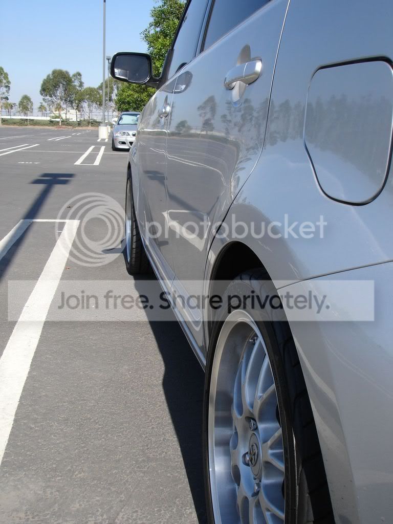

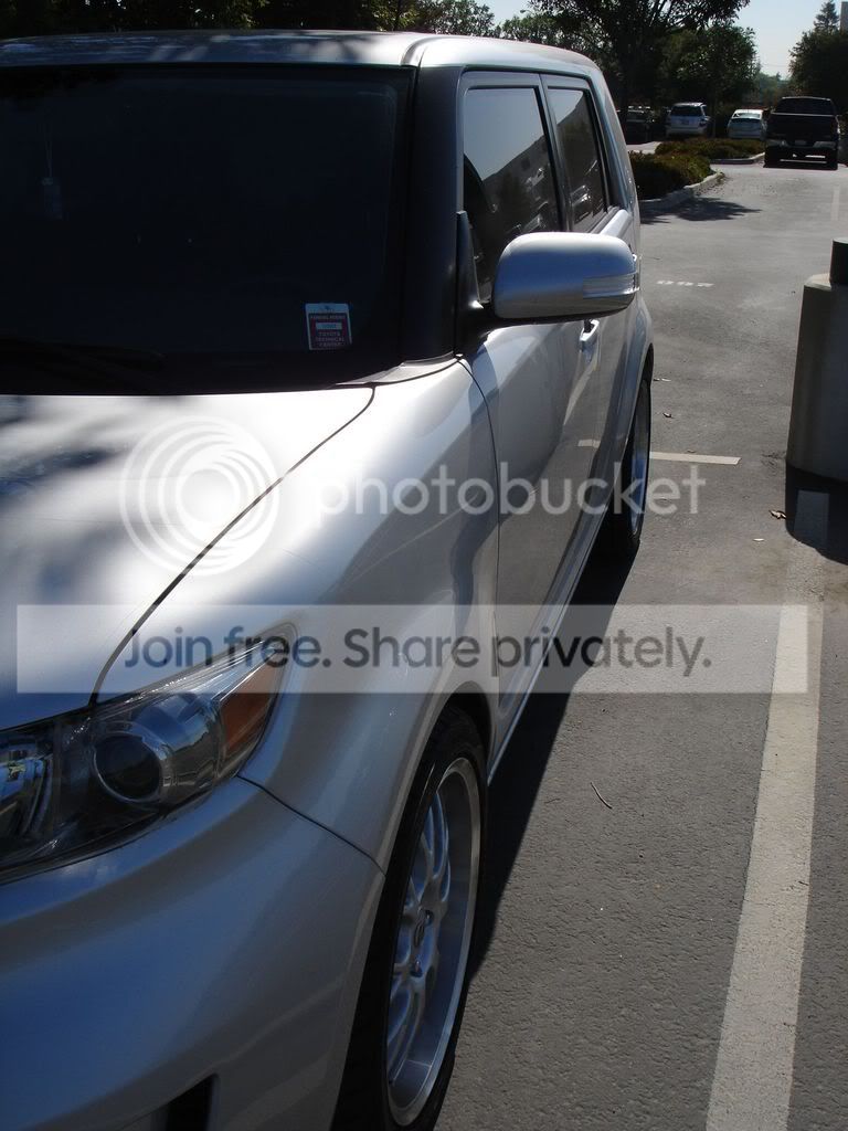

Here is mine: 235/40R18, OFFSET: +40. The fronts rub on the wheel well if I go fast on big bump on freeways, just a little bit. Otherwise, it is totally OK usually. Springs are Tanabe's NF210.

18"x8", Front: 1", Rear: 1.5"
