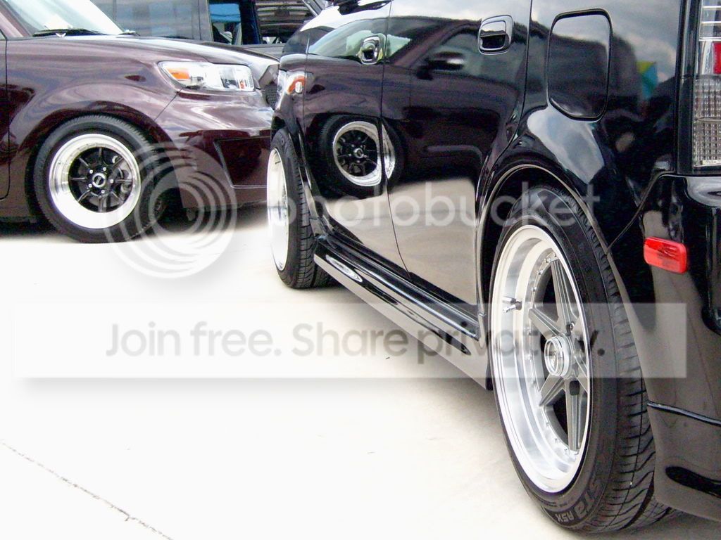

Yup. At Exposed here in FL last month-
And here it is in the backround, looks like a DF drop-
A few other guys have done zero offset, like Pandanky on ClubXB.

I can see that the tire tread is under the fenders, but I personally don't like the look of the wheels sticking out past the fender lip, or the stretched tires.
It doesn't look bad, just not my cup of tea.
I'm glad the Scion brand is designed to be modified in such a personal way; otherwise we'd all be driving cars that look the same and have no character.
BTW, thanks for throwing the pics up, I was having serious doubts that a 0 offset wheel could be put a 2nd-Gen xB without the tread sticking way out past the fenders and having terrible rubbing problems.
