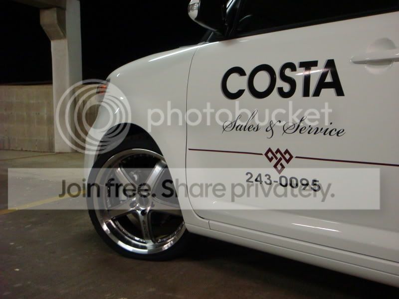

I have 19 x 8.5 and 19 x 9.5 setup with 235/35 and 265/30 toyos. here is some pictures this is with TRD drop springs and i have no rubbing

very nice

please post the offsets for the front and rear wheels
i'm assuming they are both +45, but i could be wrong...

Here they are
Wheel Specs:
Front Size: 19" x 8.5"
Rear Size: 19" x 9.5"
Pattern: 5x114.3
Front Lip Size: 2-2/3"
Rear Lip Size: 3-2/3"
Front Offset: 35MM
Rear Offset: 40MM
Tire Specs:
Front Size: 235/35/19
Rear Size: 265/30/19

that looks REAL CLEAN. i want those rims soooooo bad. i hate my credit card debt!!
