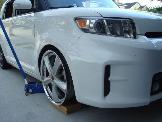

Started to rain before I could get to the back, but I'm not worried about the fitment in the rear anyway.
Opinions on both the fitment and the look? I'm a little worried about the fender surviving 20s with the Tein S-Tech drop.

Are you planning on 225/30-20 tires?

So far, that's the plan. I think a 215/30 would give me a little more stretch than what I'm looking for.

^^ Yea, that's what I thought for 20's, probably not enough sidewall height to safely stretch a 215/30 on a 20x8.5" wheel.

It's also on the tire you choose. They are def not created equal, some run wide, some square, some narrow. Looks like you've got some research ahead.

I really think you could go with a larger tire than the 225/35, but you'll probably be safer with that tire.
I wouldn't even think about 225/35-20 on the S-Tech drop, they're almost 26-1/4" outside diameter, and would surely rub heavily on the front fender liners with the 1.7" front spring drop. Play it on the safer side, and stick with 225/30-20. That way you could even add 10mm rear spacers to get the rear wheel lips to more closely match the fronts for flushness with the fenders.
