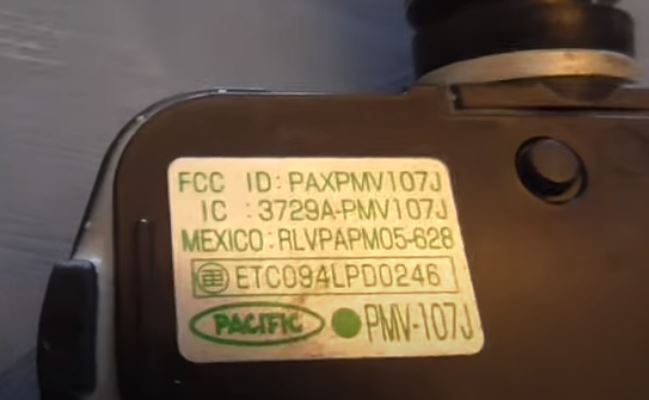

After the TPMS light flashed on, then stayed on, in our 2009 XB and reading on the internet that the batteries only last 5-10 years (depending on use)...
Looked like it was time to change the TPMS's at worst, or replace the batteries (cheaper for me).
Spoiler alert - changing the batteries worked.
It takes time, but if you have the time and gear, it can be worthwhile as a DIY project.
I'm copying most of the text under the video here as I don't know if it will show on a phone
Deleted other referenced video links to save space.
The Battery needs to be a BR2450A. And specifically a BR-2450A/FJN
This one has the correct tabs already attached to the battery. The BR batteries have a higher temperature rating !!!
125C(257F) Verses 60C(140F) for CR2450 batteries. Tires get hot, so best to err on the safe side, specially in Phoenix AZ.
Could not find them on Amazon, but Mouser.com had them in stock. Here's a link to this most reputable dealer. They even keep up their "in-stock" numbers - unlike some giant hardware stores... https://www.mouser.com/ProductDetail...xi6IiiHg%3D%3D
Check out the Panasonic data sheet on their page for battery details. I had to trim the 1.8mm tabs slightly on the inside so they could fit the 1/16" (1.5mm) holes I drilled in the TPMS circuit board. Used a wire snipper.
I tried to get special electrical RTV, but the one I got smells like it has acetic acid in it, so not the best. I thinned it down with odorless mineral spirits (still smelled) to make it pourable.
I already have tire changing equipment, and basic soldering tools, so this was not an extra cost for me. If you don't have these things, it's a cost consideration for you.
Costs for me were the batteries, RTV & Mineral spirits which at 2023 prices were around US$40.
The best I can tell is that the dealer will be charging upwards of $400, Discount tire upwards of $300 to replace the TPMS's.
Paid for this at a dealer etc, let me know in the comments section.
If you buy new TPMS's and fit them yourself, you will need to get a relearning tool so the cars computer recognizes the new TPMS serial numbers. Those tools are not cheap!!! Replacing the batteries and re-using the original units avoids this expense.
I'm sure I've missed some details, that is what the comment space is for. Hope this helps you avid DIY'ers.

I don't need to remove the tires. I only need to expose the sensors to read the numbers for registration. My tire shop only installed the new sensors. They did not register the new ID numbers.

If the registration numbers are anything like the OEM sensors, I think they are on the flat side of the sensor, facing the drop center, so you will need to flip them round.
The nut on the valve stem is either a 11 or 12mm A/F.
I don't know which are the reg numbers

I ended up not having to break the tire beads. I instead used two TPMS scan tools. One scan tool is wireless but doesn't have OBDII. The other scanner has OBDII but no wireless reader. One tool with both features was prohibitively expensive.
Fortunately everything worked. The wireless scanner read the installed ID numbers, which I then hard-keyed into the OBDII scanner. As soon as I hit the "register" button, the TPMS warning light went out. Yay!
