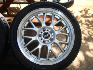

Thanks for the replies guys! Ive searched memoryfab & other JDM wheel sites, but I just figured a few hundred for adapters would be cheapest. I haven't calculated any measurements yet, but the
ASA wheels are 17x7 +35 offset & I already have 215/45 tires on them. And the spacers I've found are 19mm thick on this site... http://www.motorsport-tech.com/ and they have 5x114-5x100
I'm not fully committed yet, but ill see how it goes. here's the ASAs

Once it all said and done and the spacers are on the final offset would be +16 for your 17x7 wheel. I don't know how agressive of fitment are being run on xB2, you might have to fender roll, IDK if your car is lowered or plan to.
