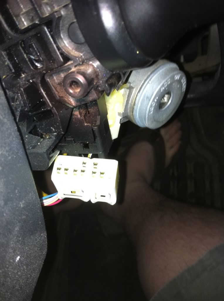

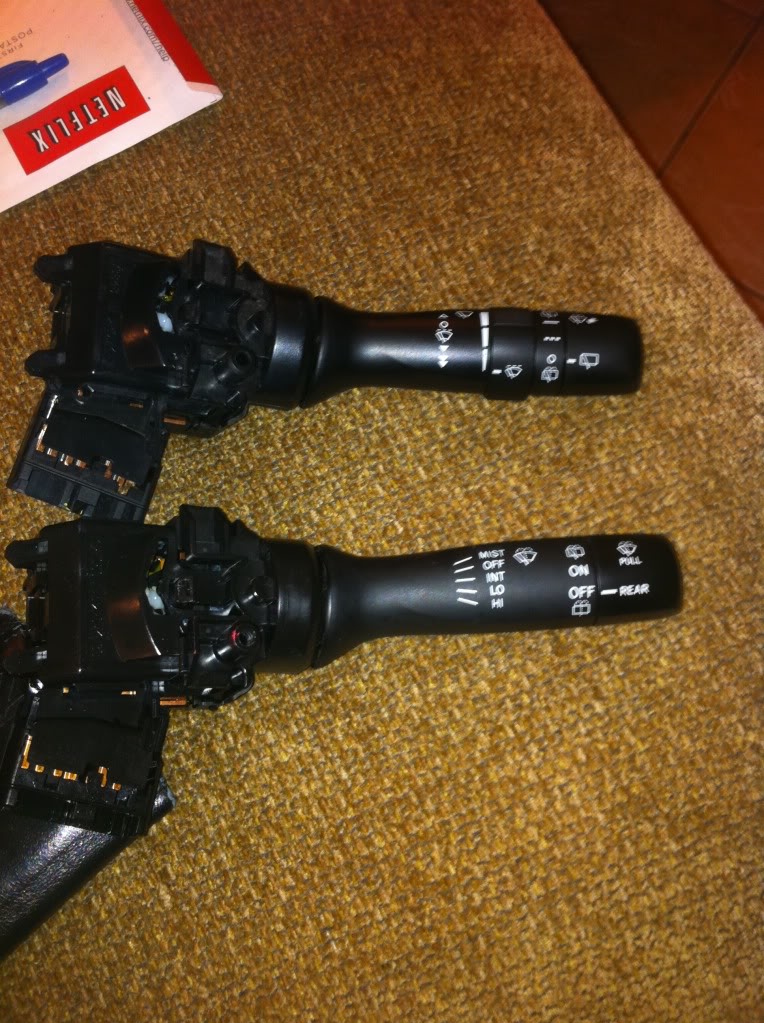

Mine did not work. I bought a yoke from Ebay for a 09 Vibe. Just tried to install it. It plugged up correctly but only the basic XD functions worked. No adjustable intermittent on the front as well as the rear wiper just did not function on intermittent on the back. It can spray washer fluid front and back, the three speeds on the front work, and the on position works for the back wiper. Which yoke did you guys get?
Size:  114.7 KBTop 09 vibe bottom 08 XD

Size:  71.8 KB08 XD pins
