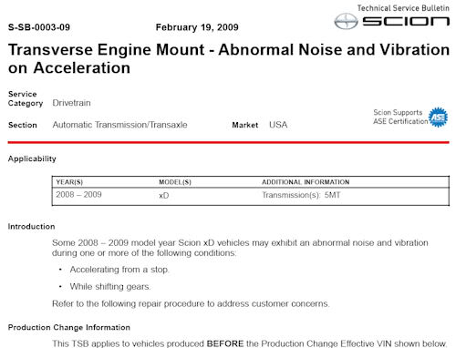

I had read a post a while back (before the forum change) about a member who was experiencing this and was able to fix it because one of the cables to the tranny had moved and was rubbing on the frame or body or something...
That was probably me. It turned out that they routed the cables wrong when they installed the TRD quick shift kit. This could be the case here, but there was also a service bulletin on motor mount failures that would also cause squeaking when clutching and shifting.

Old Sep 29, 2009 | 02:38 AM
mcbrew's Avatar
Joined: Nov 2008
Posts: 1,023
From: Annapolis, MD

seems that's for auto only?
Old Sep 29, 2009 | 02:26 PM
mcbrew's Avatar
Joined: Nov 2008
Posts: 1,023
From: Annapolis, MD
It's a little confusing. It is listed under Automatic Transmission/Transaxle, which means autos AND manuals, or transmissions in general. You'll see further on that it lists as being an issue with the 5MT, which is 5 speed manual transaxle. The service bulletin is ONLY for cars with 5-speeds.
This pic from the second page of the TSB shows the part to be replaced, which is labeled as (1).
