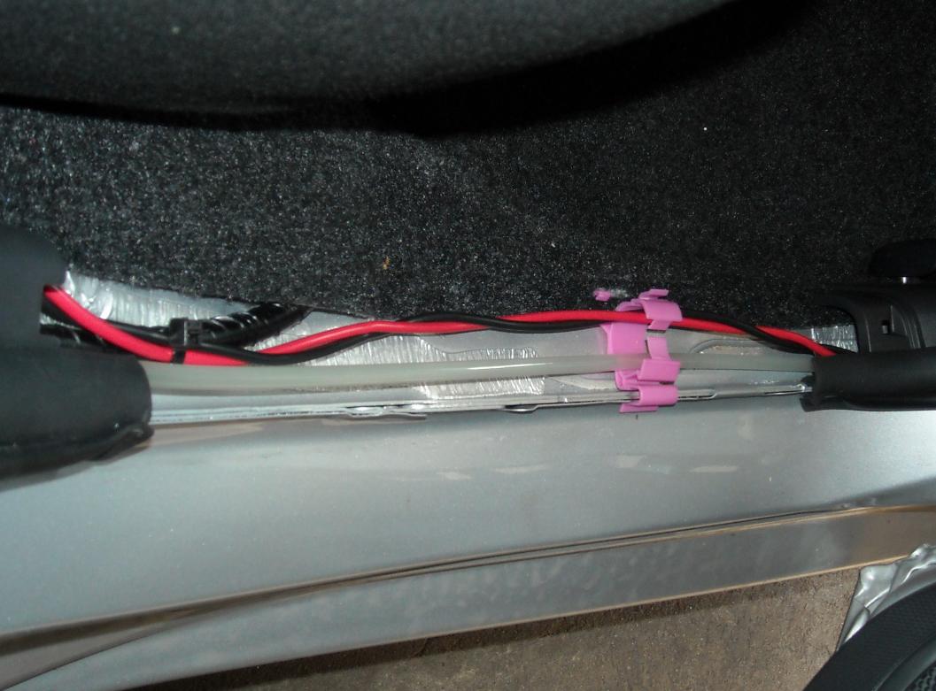

Below is the sub which is in sealed box. Lot's of room in the hatch area. I ran my own twisted pair or 12g wire under the rear passenger threashold, behind the folding rear seat, and ending at the sub.

Amp & Sub Install, 2010 xD, Pics and comments-20-my-own-12g-sub-wires-rear-pass-threasehold.jpg
