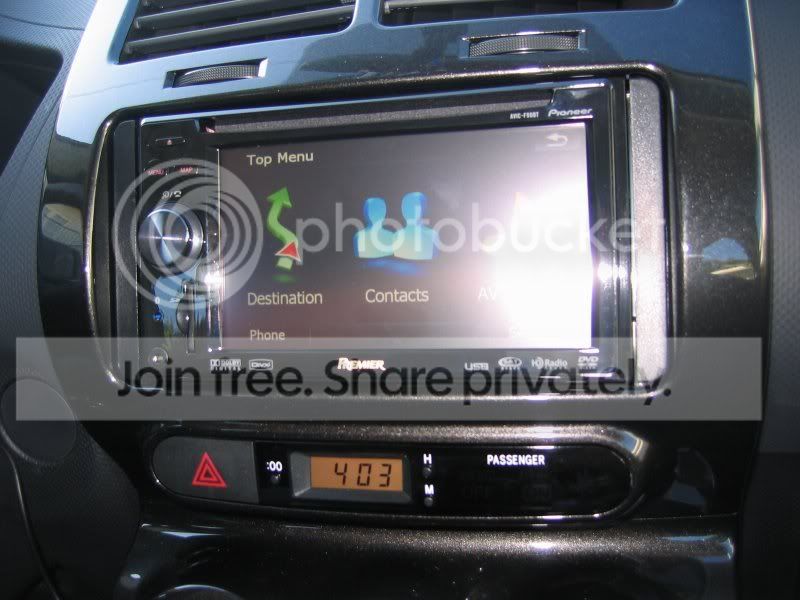

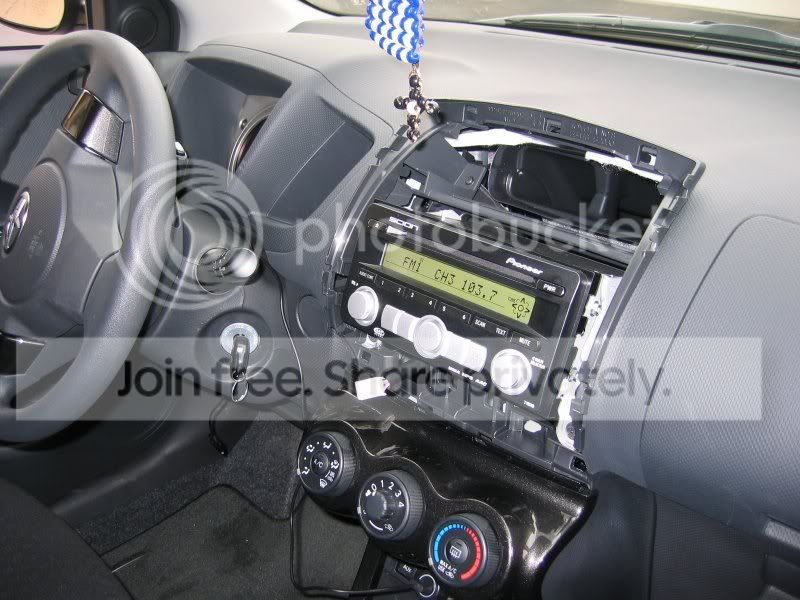

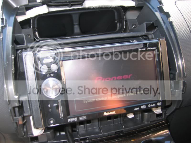

hi guys, i think this is my first post on this forum, so i have a 2008 xD really happy with the mpg and the car! The stock radio kinda sucked for me, plus i wanted a GPS cause i drive around a lot, so i decided to get the AVIC-F90BT. The unit is awesome if u dont mind the long boot up (about a minute) So here goes the details, pics :

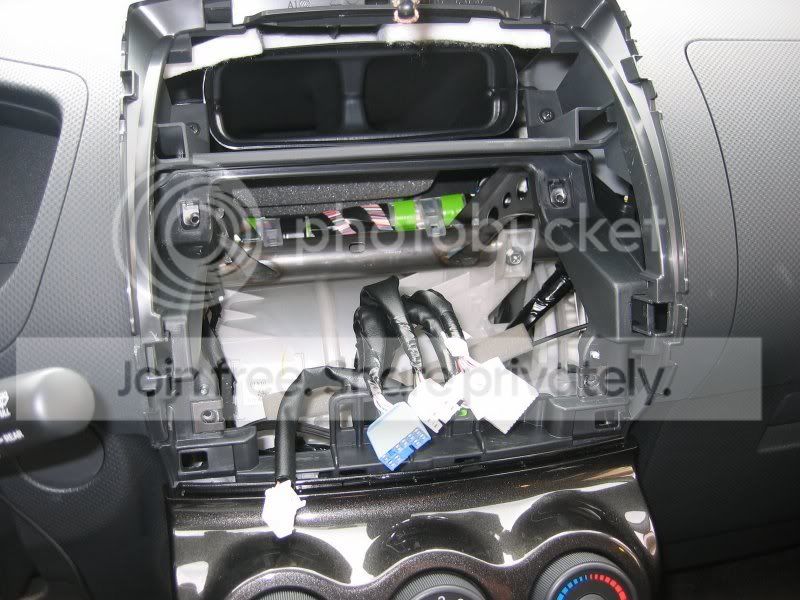

Taking Factory Stereo out:

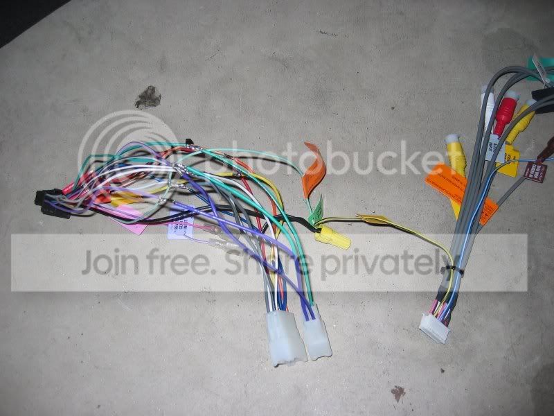

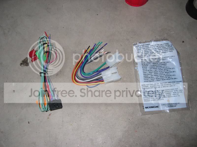

Wire Harness

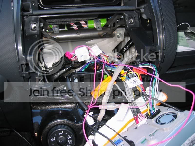

Ready for the new unit:

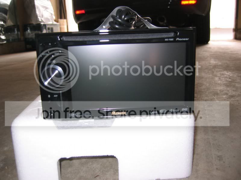

The unit:

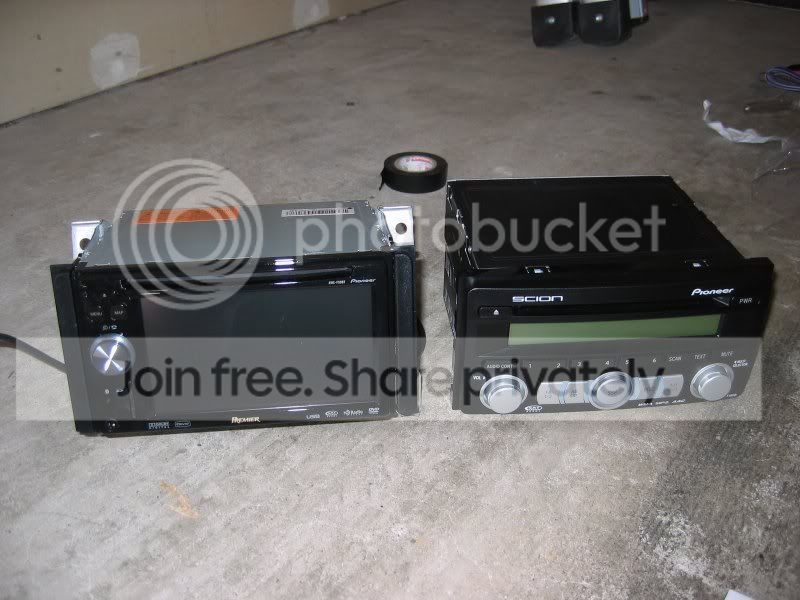

Comparison

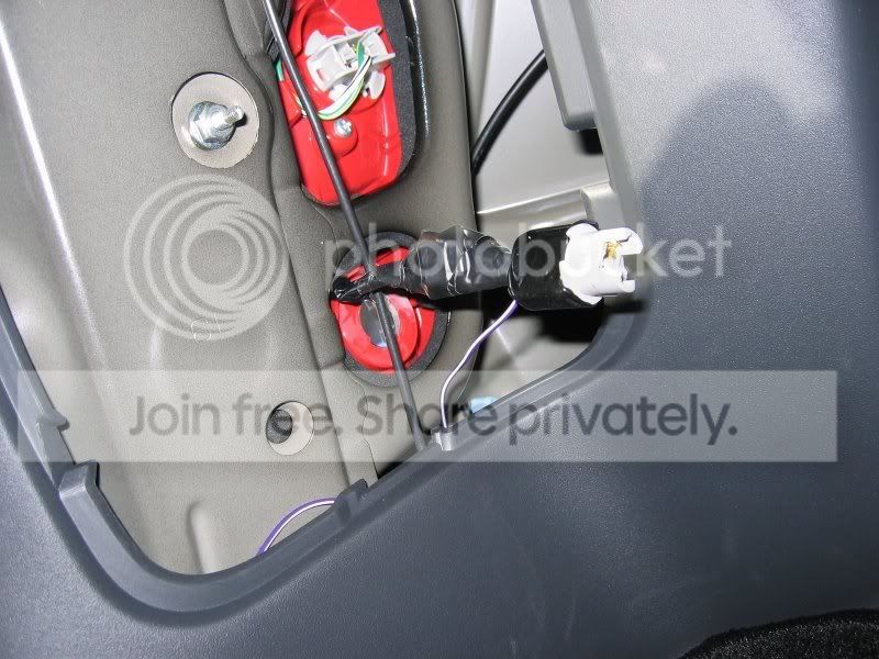

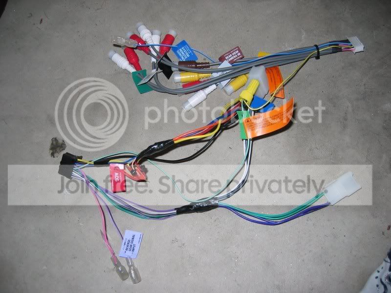

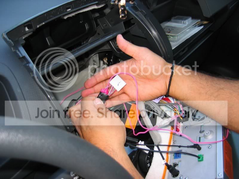

Hooking up reverse signal (tapping on backup lights)
Tapping into VSS (Vehicle Speed Sensor)

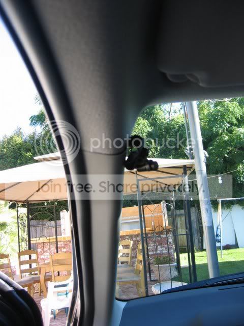

The microphone (for bluetooth connection)

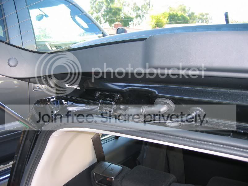

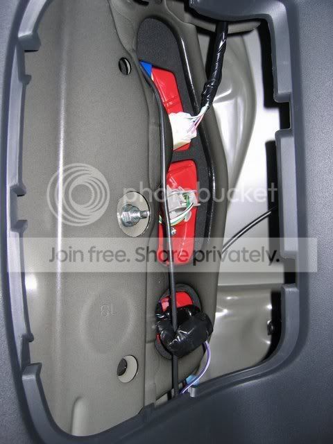

GPS Antenna
How the GPS Antenna cable is going to the stereo...

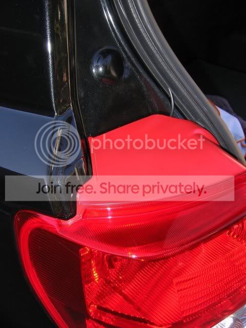

Inside the light fixture
And down towards the front of the car

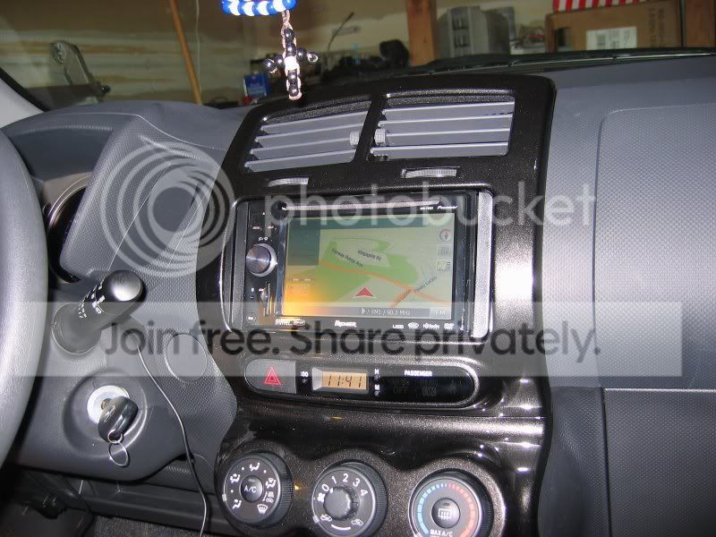

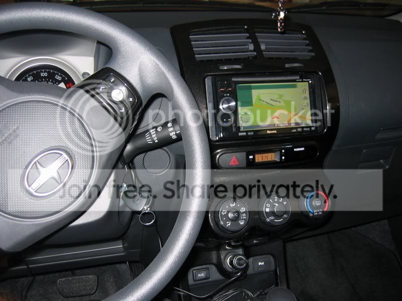

End product:
Bluetooth connection established !
All ready installed!
The sound quality is awesome, installation took like 2,5 hours but i took my time and have done this for a few other cars and friends cars... The xD is a very easy car to work on. Now the sound is 10x better than stock.. Bluetooth conversation is awesome too. GPS signal is excellent, i have seen other putting the gps antenna on the dash but i wanted a more "clean look"

dang buddy that looks pretty slick. i like that alot. how come you had to tap into the vss? i'm pretty much clueless when it comes to installing these.
Old Sep 22, 2008 | 05:14 PM
takissd's Avatar
Joined: Sep 2008
Posts: 6
Thanks! According to the manual and the AVIC 411 forum, the gps works better when it gets the speed from the VSS line... i think it uses it when u get under a bridge or a tunnel and it loses the GPS signal, but at least it knows u are moving since it can read your speed from the VSS. I never really tried it i just did it anyway!

Originally Posted by STNC
looks good!
what wiring harness did you use?
Scosche TA02B / TA02
and the 2 Black plastics on each side of the unit to fill up the gap are:
Scosche TA1465B / TA1465

what wire is the VSS?
lol
the 12 chubby pin, or the 12 thin pin?

I thought about running my Cb antenna cable through the taillight like you did, but the major concern i had is water getting in around the wire and into the tail light or interior metal of the car. Does your wire produce that problem?
