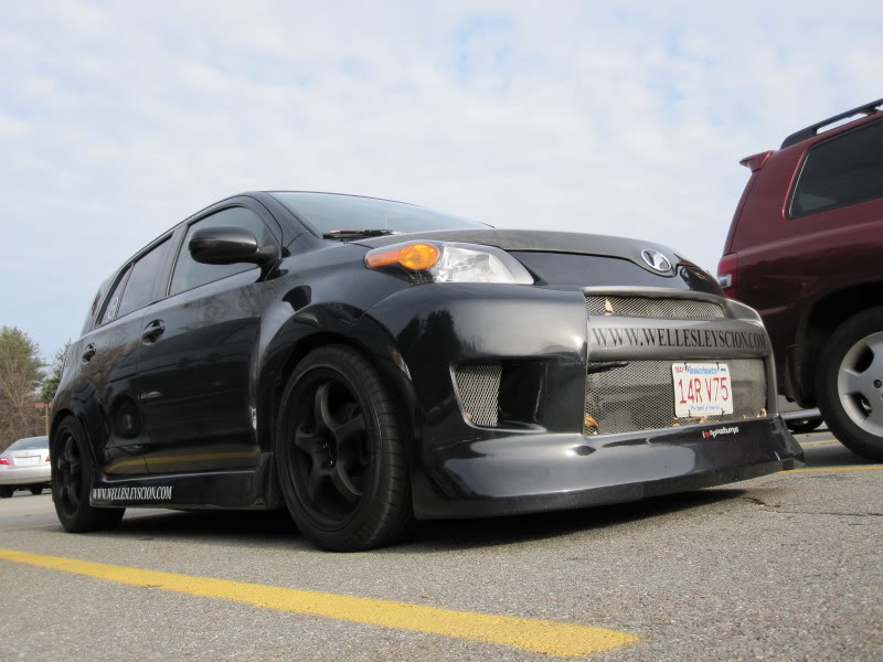

Is anyone running these specs, and would it be flush or a slight poke?

Originally Posted by SoleLaced
neither. Its not aggressive enough to be flush. Please search the wheel thread next time.
On a tC it wont be flush... He drives an xD though... Please read the section your posting in before you answer next time...
To answer the OP, 17x8 +35 will be a perfect fitment, its what I have on my xD, sorry I dont have a closer pic but this is what you will look like with that size/offset:
are you running any spacers??? because im running 18x9 +30 and my rear is as flush as you can get.... without some poke? is the tire flush with the body or is the face / lip of the rim flush with the body?

again, the fitment of the wheel varies on design. i have a 17x7 +35 and i leave about 5mm to the edge of the fender. so that extra half inch on each end of the barrel makes a difference too.
