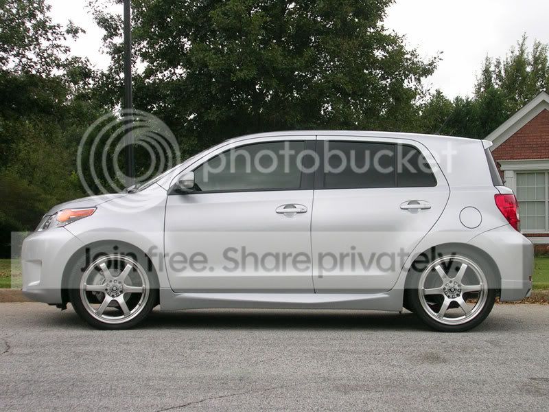

These are 18x7.5 ET 42 with 215/40R18.
Old Mar 6, 2008 | 03:15 PM
zoltiz's Avatar
N.G.S.O.
Posts: 1,533
Leo, you are a liar, Look up my order details ;)
Good to finally see you here, btw. The tires are 225/40/18, not 215, but you are dead on as far as wheel size goes. I've put a 5mm spacer in the back and it works out ok most of the time except for really sharp U-turns at a decent speed - then it chirps a tad.
Here's a recent picture:
I'll PM you with a tire question.
P.S. Guys - Leo here is a great guy representing a great company. I've been buying wheels and tires from EdgeRacing.com for 5 years - service and prices were always extraordinary.
