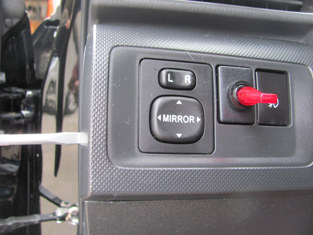

-Using the same screwdriver, place it behind the mirror control trim and pull out to pop the first clip. Once this is popped, pull the rest of the mirror control trim out

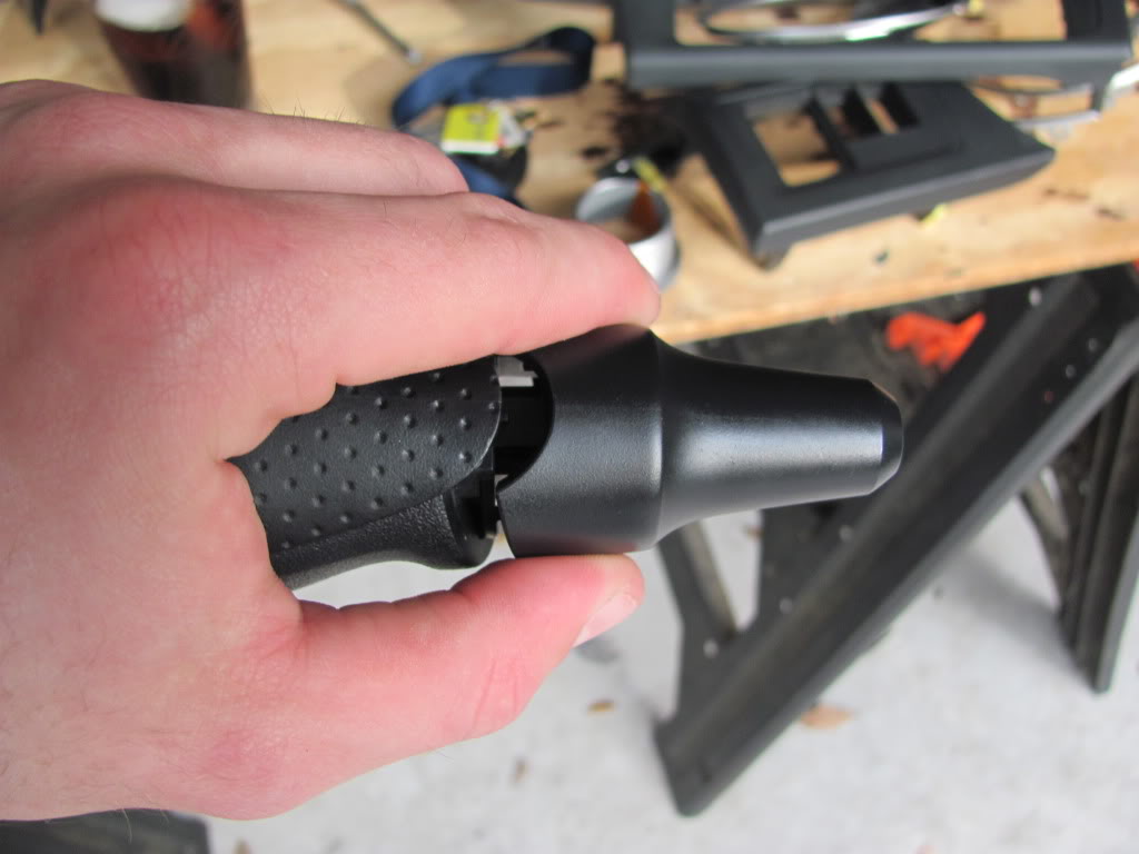

-Twist off the shifter ****

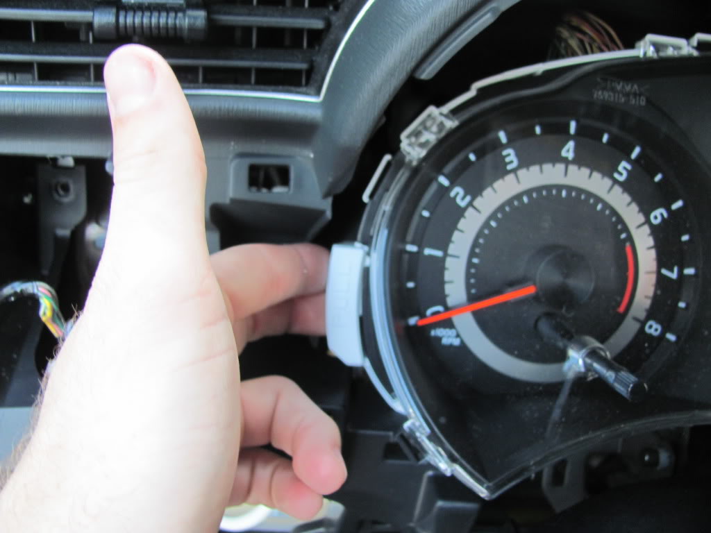

-Remove the speedometer by pulling away from the dash and disconnect it from the harness

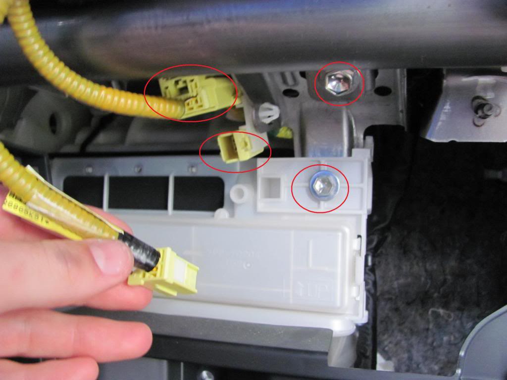

-Remove the 2 airbag plugs and the 3 bolts that were behind the glove box

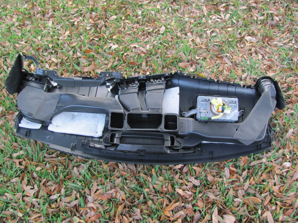

-Pull the whole top dash out, be careful as the passenger airbag will still be attached to the dash. This will come out with the dash

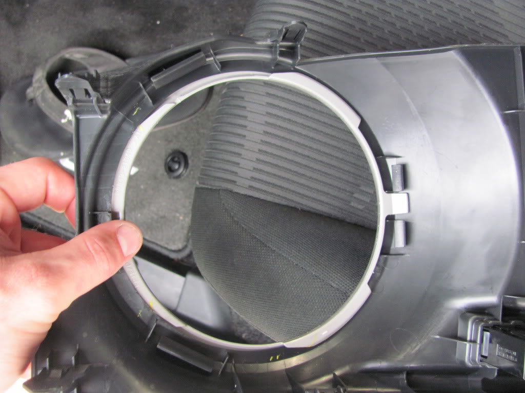

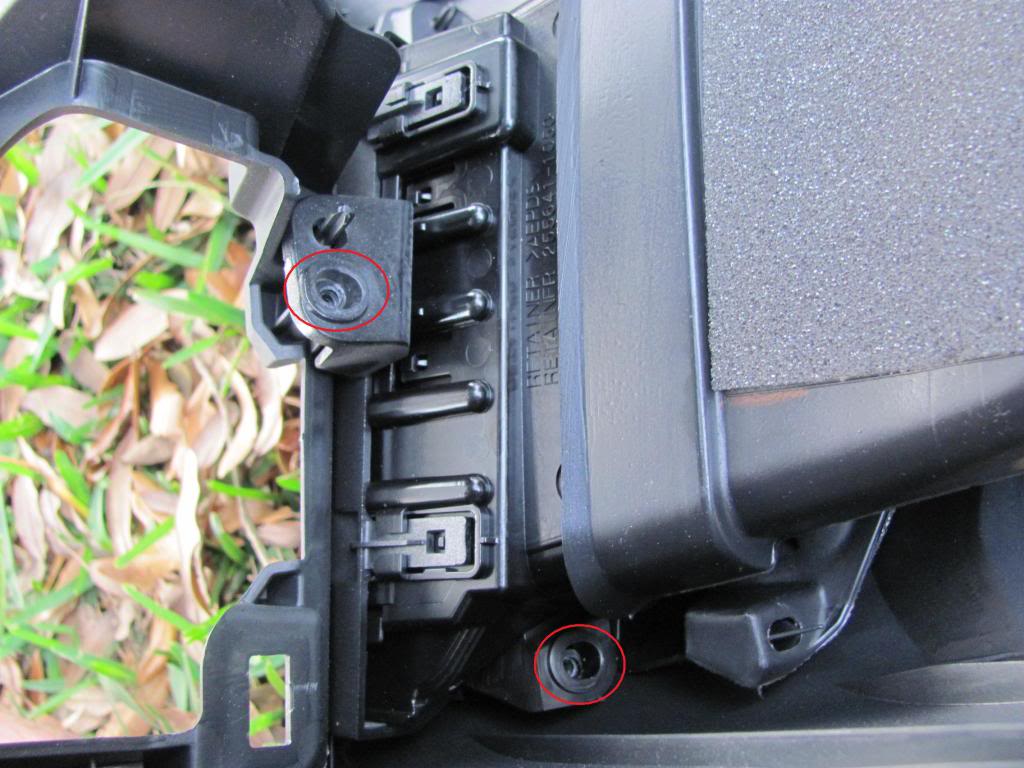

-The drivers vent and the middle vent can be easily taken out the back once these few screws are removed

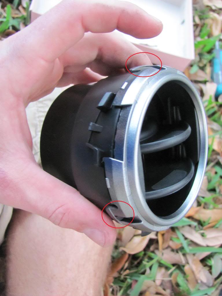

-The aluminum trim can be pulled off of the vents by pulling the multiple clips around them and then pulling the trim off

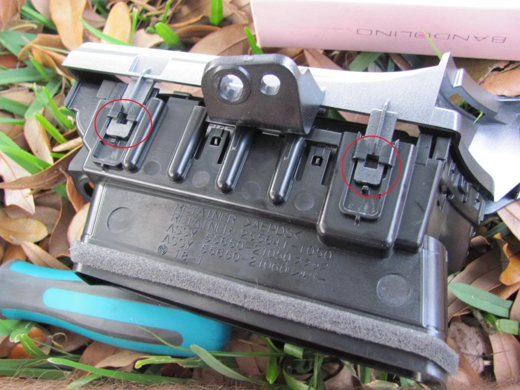

-The passenger vent can be removed by pulling off the 2 clips and pulling the vent out the back

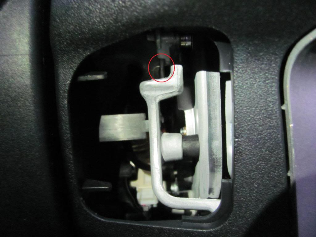

-A small vertical rod can be seen from each side. Using a screwdriver, push this rod towards the other side to release a locking mechanism. Do this for both sides

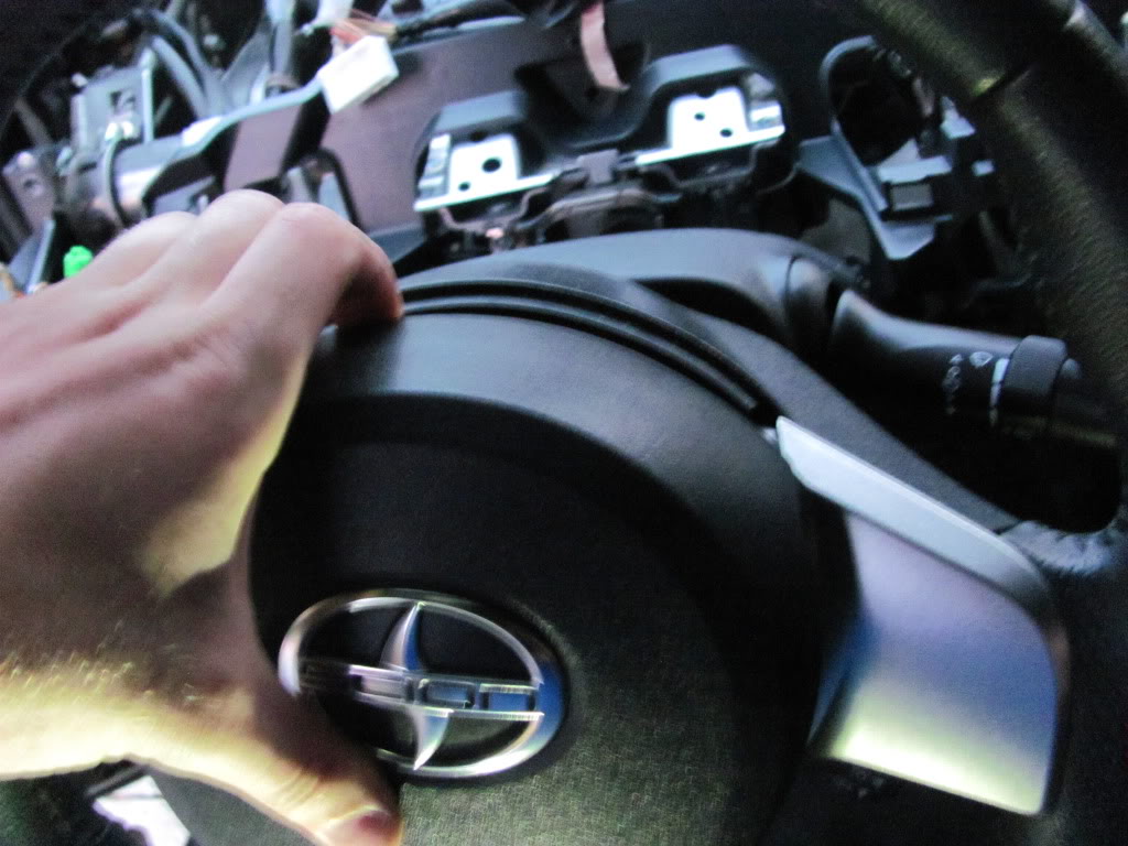

-Pull the center of the steering wheel out and place it on top of the steering wheel. It can be unplugged and completely removed, but I did not

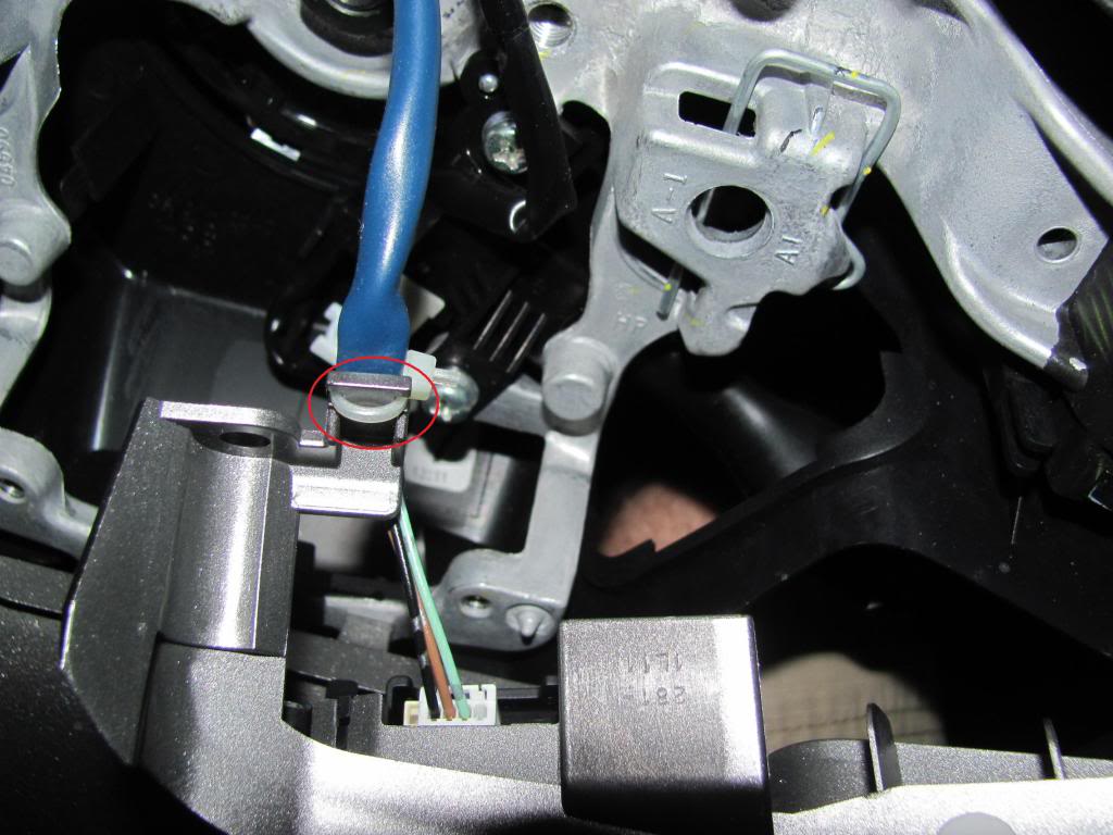

-Using scissors, but the zip tie holding the wires going to the steering wheel controls. Also disconnect the steering wheel controls

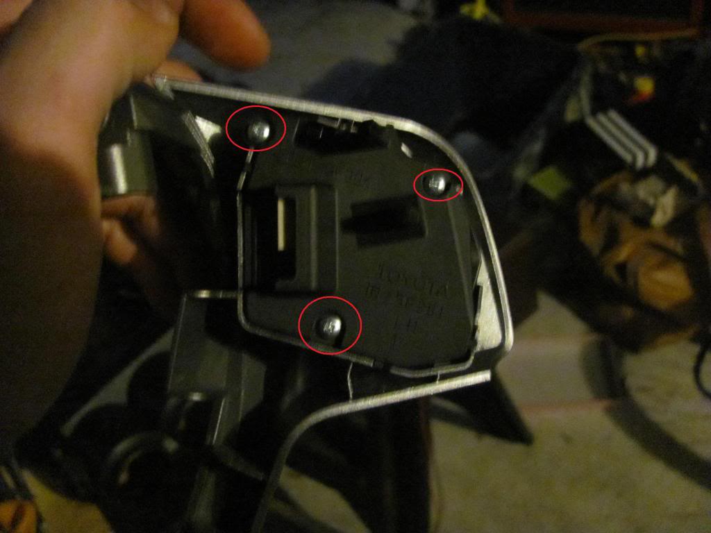

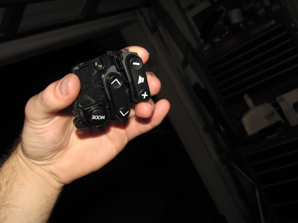

-Remove the 3 small Phillips head screws holding the steering wheel controls to the steering wheel trim
-The controls can now be taken out the back of the trim

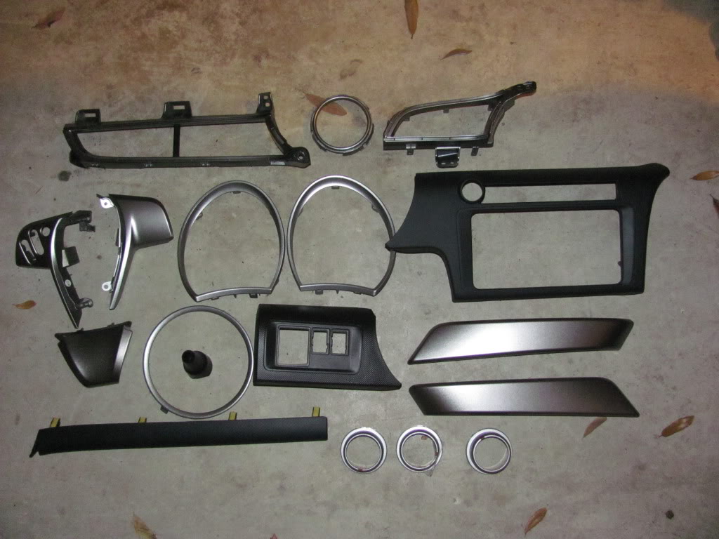

-Now relax because you have removed a whole _____ ton of trim!!
Now Paint and do the exact opposite to reassemble!
