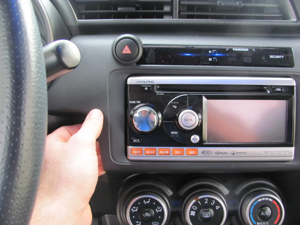

-Using the same screwdriver, place it under the radio trim and pull out to pop the first clip.
Attachment 22189
-Once the first clip is released, pull the trim away from the dash. Once again, don't be afraid to use force.

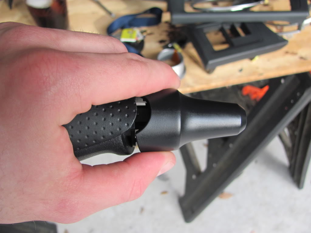

-Pull off the shifter knob trim from the shifter knob. Simply pull the trim away from the rubber

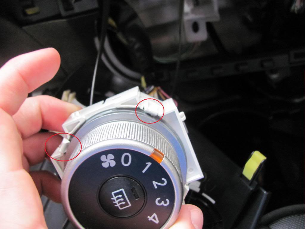

-Remove the A/C Gauges by pulling out the clips from each side of each gauge. Then pull the gauge out of the back
Attachment 22210

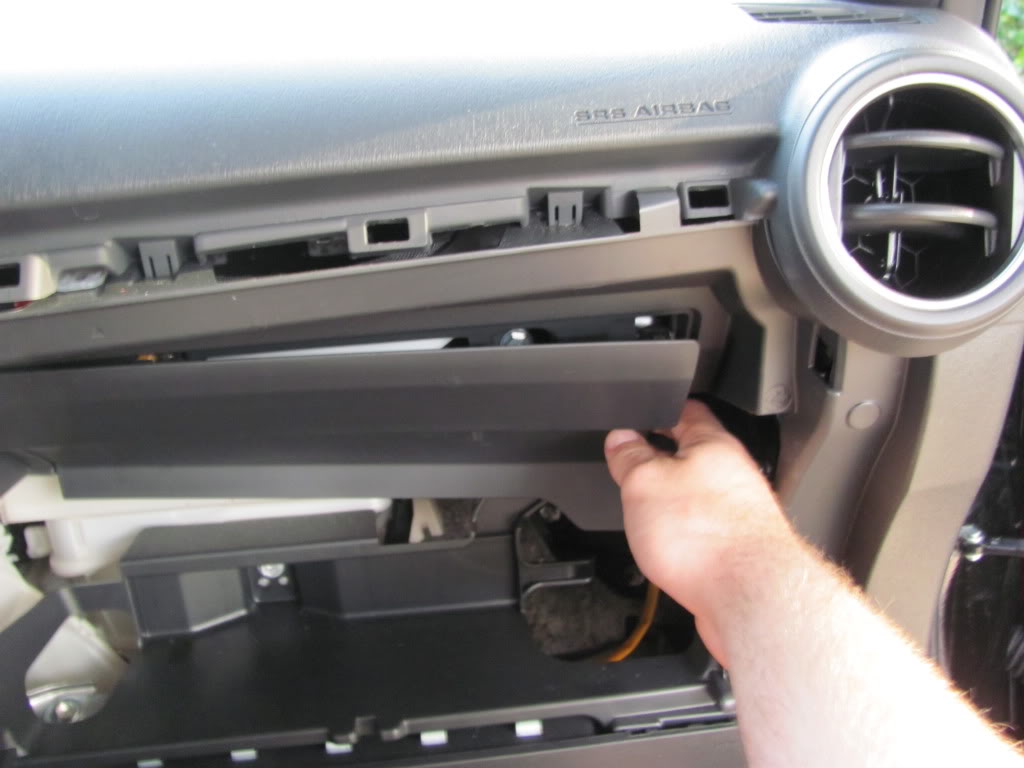

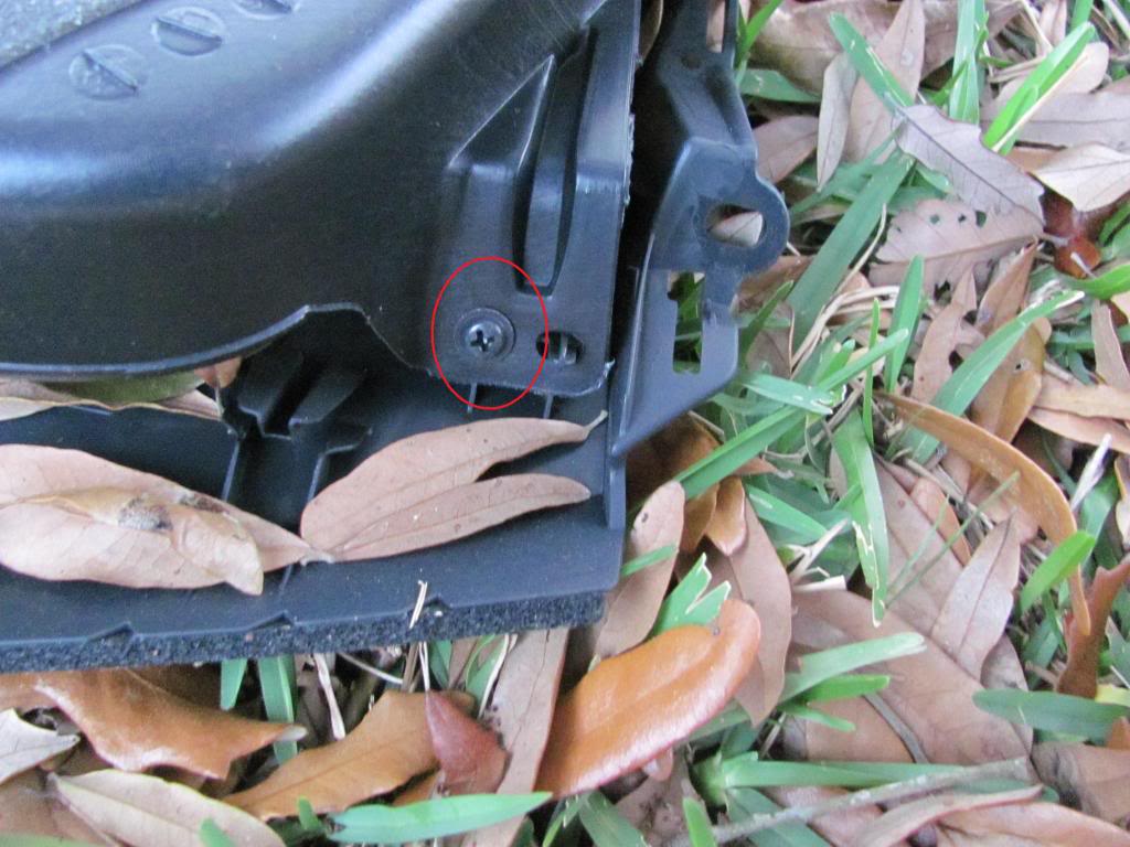

-Remove the glovebox by pushing in each side and pulling out
Attachment 22212
-Remove the dash piece behind the glove box. Pull it away from the dash

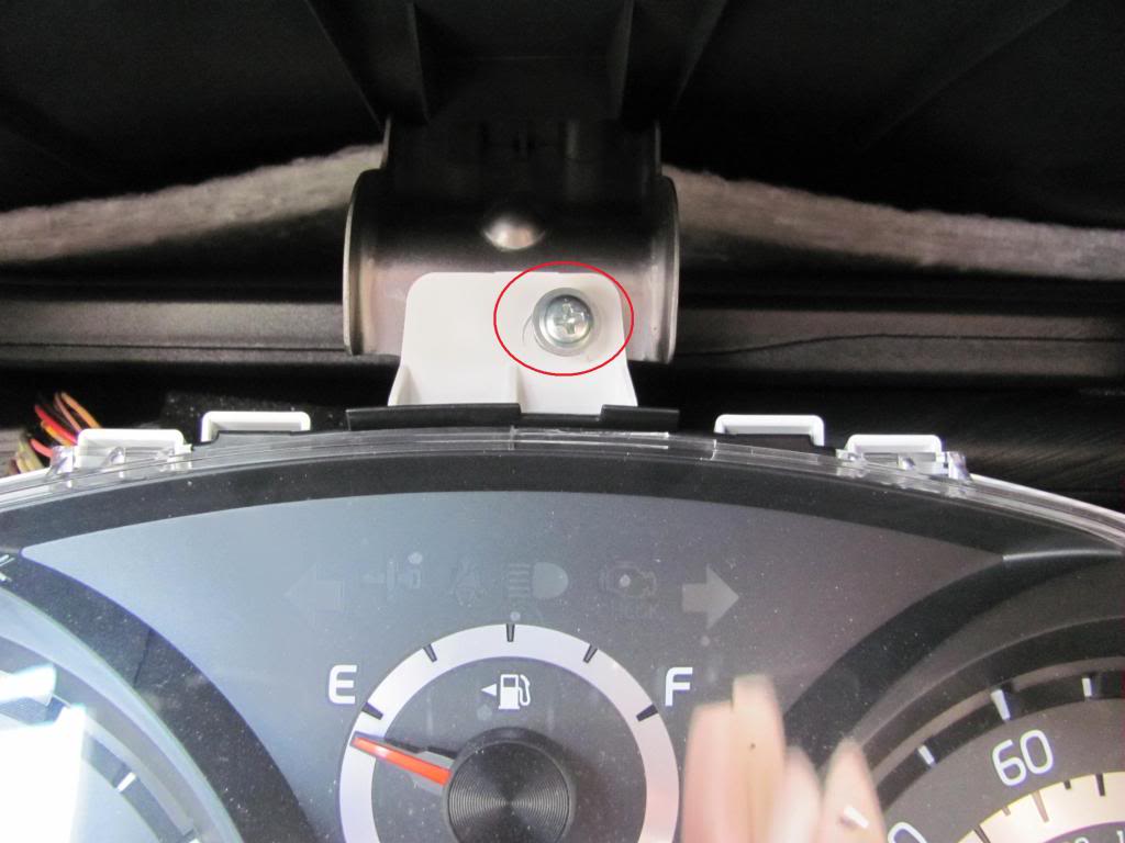

-Remove the 2 screws there were behind the speedometer
Attachment 22219

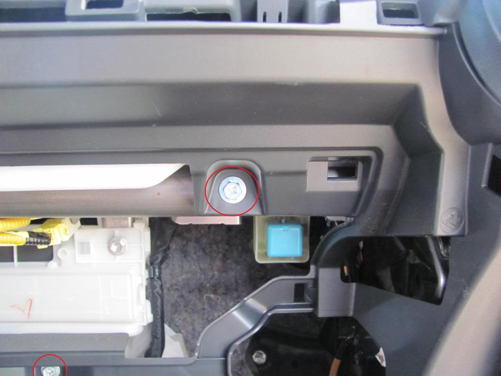

-Remove the 2 airbag plugs and the 3 bolts that were behind the glove box
Attachment 22220
Attachment 22221

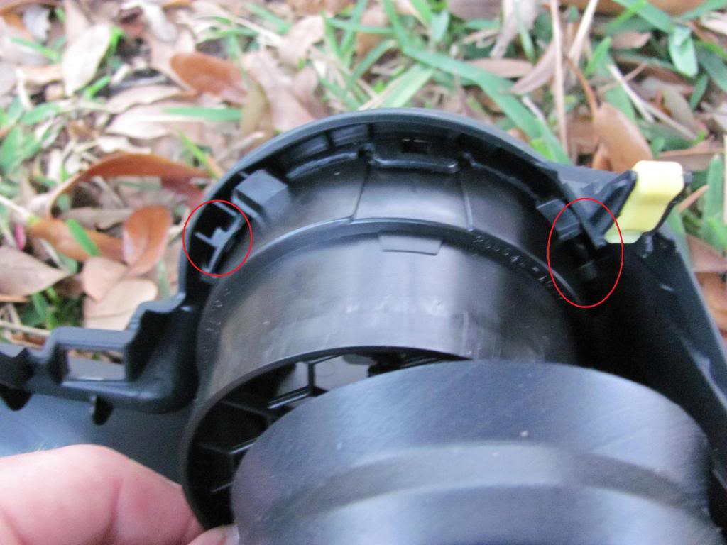

-The drivers vent and the middle vent can be easily taken out the back once these few screws are removed
Attachment 22232
-The aluminum trim can be pulled off of the vents by pulling the multiple clips around them and then pulling the trim off
Attachment 22233

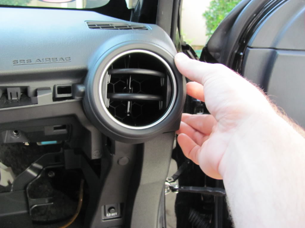

-The passenger vent can be removed by pulling off the 2 clips and pulling the vent out the back
Attachment 22234
-The aluminum trim can be pulled off by pulling the clips up and pulling the trim off the front

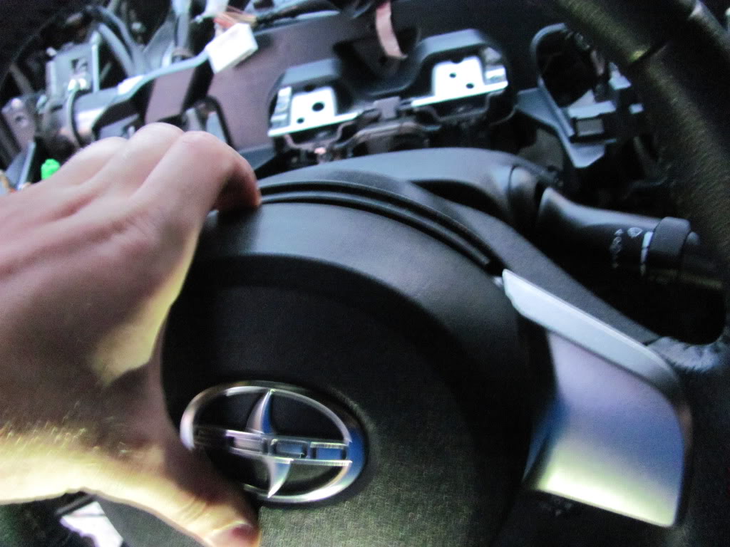

-Using a small flathead screwdriver, pop out the panel on each side of the steering wheel plastic
Attachment 22236
-A small vertical rod can be seen from each side. Using a screwdriver, push this rod towards the other side to release a locking mechanism. Do this for both sides
Attachment 22237

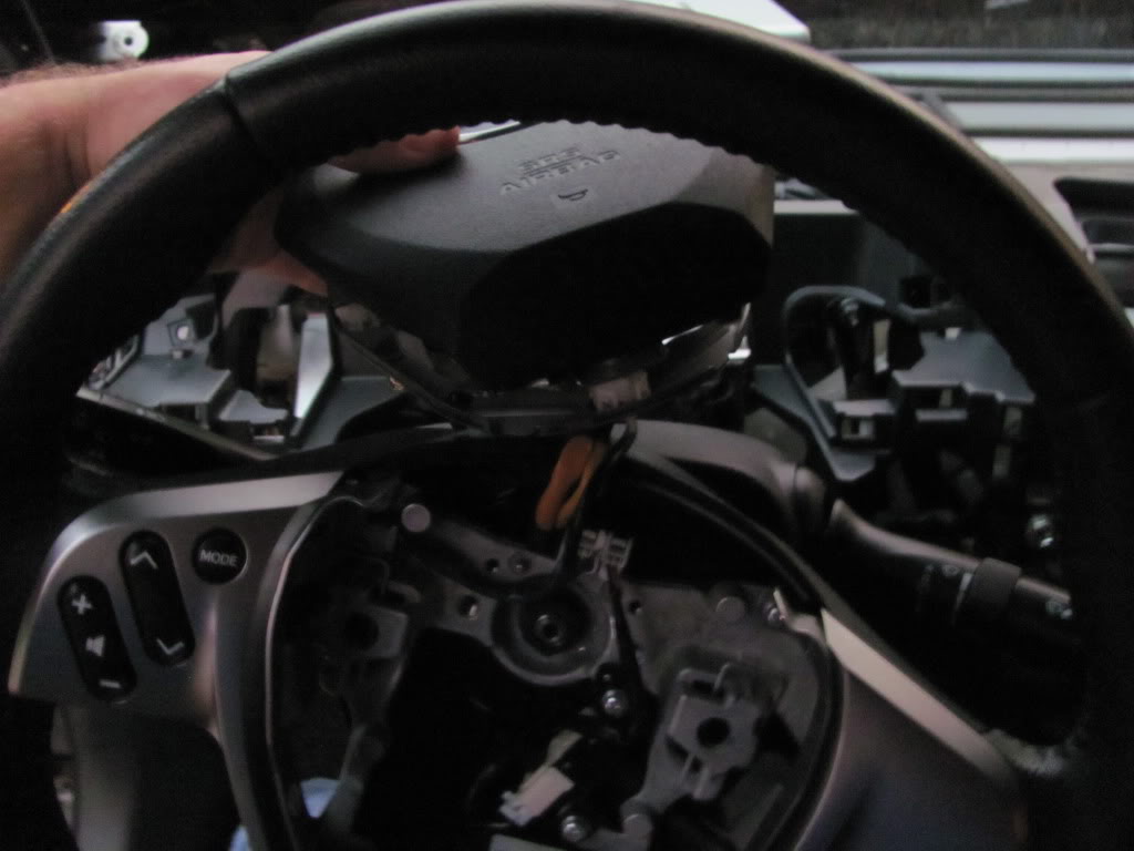

-Pull the center of the steering wheel out and place it on top of the steering wheel. It can be unplugged and completley removed, but I did not
Attachment 22238
Attachment 22239
-Remove the 4 phillips head screws in the center of the steering wheel

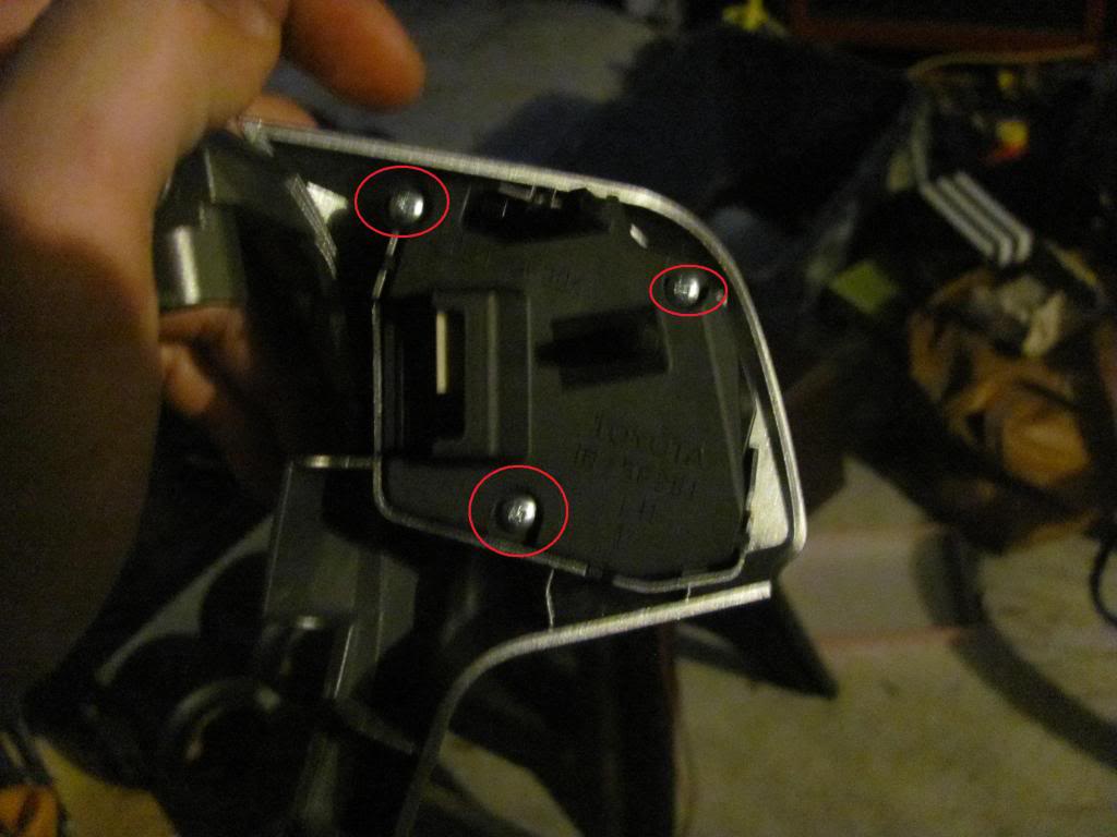

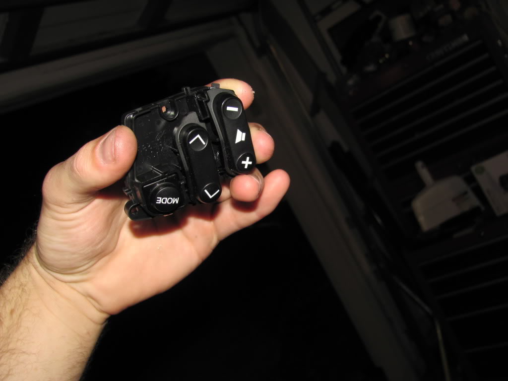

-Remove the 3 small phillips head screws holding the steering wheel controls to the steering wheel trim
Attachment 22246
-The controls can now be taken out the back of the trim
Attachment 22247

on the radio trim for dash? you dont really need flat head screwdriver. just pull it with hand...
