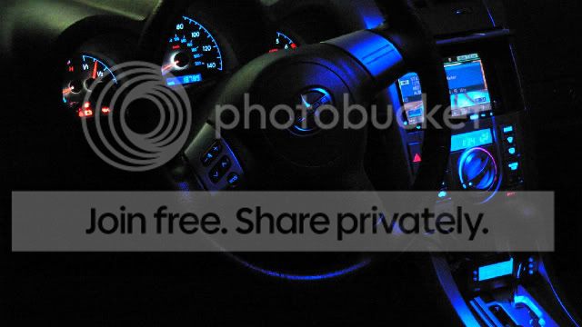

After hours of cursing and a six pack, I'm finally done with my swap. I bought all my stuff from garage.
My radio will go under the hot iron next after my leds come in. Overall its been a fun project that I'm so proud of. I love driving at night!

so did you do white leds with blue vinyl or blue leds with blue vinyl.. because your numbers look white but the glow behind the needles look a little blue

I used white leds with blue vinyl.
